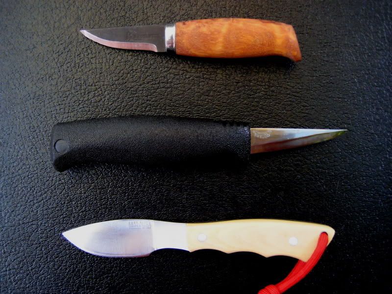

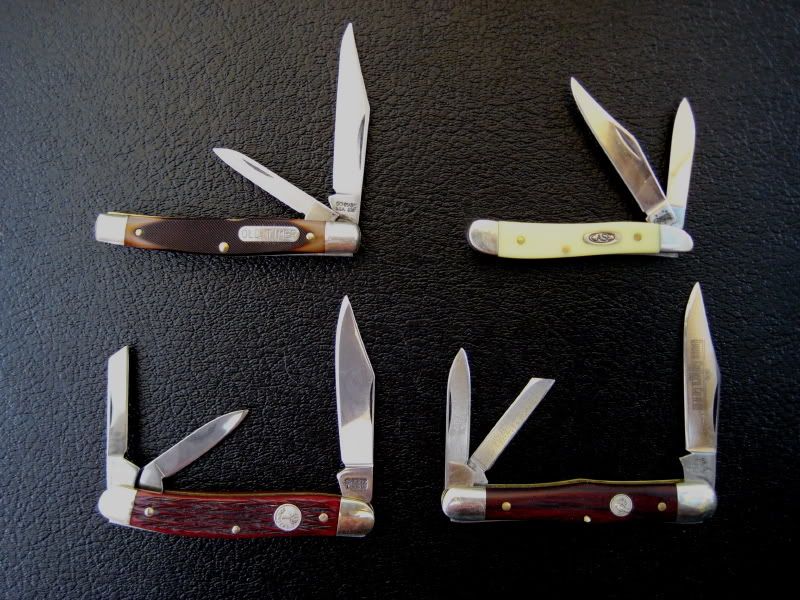

Knives like these are fun to whittle and carve with:
But knives like these work better for me:
There are several steels represented in the above knives -- D2, 1095, CV, A2, and 12C27. All of these steels are suitable for carving. Some may need sharpened more often than others but when you whittle you need to keep something handy to touch up the edge anyway, like some 2000 grit sandpaper a strop.
