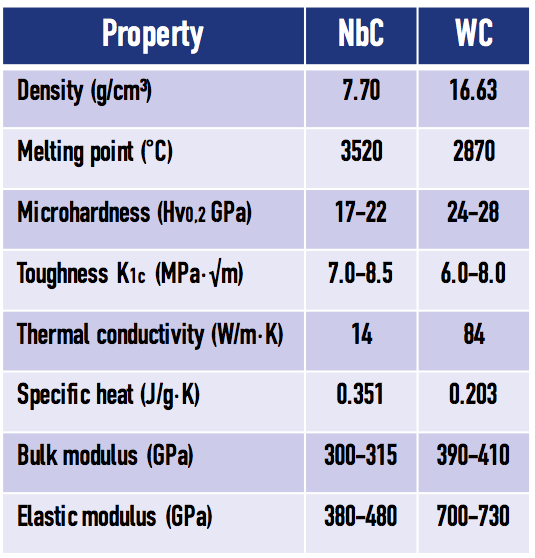

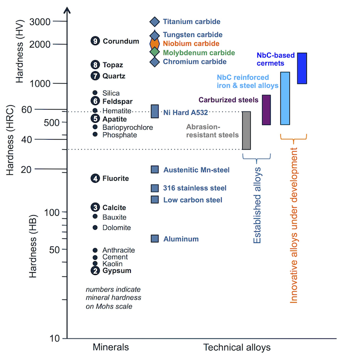

I'm not so sure Niobium Carbide (NbC) is harder than Vanadium Carbide. It's kind of hard to find specific hardness values for it, but the one charted reference I've seen (below), from an industry technical services source, indicates it's somewhat less hard than tungsten carbide (WC). If so, it'd also be less hard than vanadium carbide, silicon carbide and maybe even aluminum oxides, or some versions of them.
Sometime ago i found these specific values:
Vanadium carbide - 2950 Vickers
Niobium carbide - 2400 Vickers
Chromium carbide - 2280 Vickers
Molybdenum carbide - 1950 Vickers
I’m not sure where I read that comment on Niobium Carbide being harder than Vanadium Carbide :eek:

What bugs me about that, like a lot of other claims in general, is there's no number attached to the hardness claim, or even a citation of the source of data for it. The zknives site is one I usually put faith in, but I'd be interested to know what the factual basis for the statement was.
Even among the (much, much more technical) published articles from scientific/research/engineering sources, the numbers seem to be all over the map. Many companies or researchers seem to be experimenting with making or using niobium carbides, using a wide range of exotic or specialized processes (none of which seem even remotely similar to the way cutlery steels are manufactured), with widely-ranging results. Most seem to focus on using it as a wear-resistant coating, using some sort of deposition/diffusion process. I've seen one reference to what's called 'ternary carbides' (three elements forming them), one of which is a carbide formed from vanadium, niobium and carbon (called 'niobium-vanadium carbide', NbVC2). A charted hardness value for that particular carbide has it being harder than vanadium carbide itself. But in every instance comparing NbC (niobium carbide) to other carbides we're familiar with, like tungsten carbide or vanadium carbide, all are showing NbC to be at least somewhat less hard than VC, if not much less hard.
I get the impression it all comes down to the very specific processes used to create it, which seems to make all the difference. I haven't seen anything yet, describing a specific method or process in which it's used in alloys to make cutlery/tool steels specifically, or what hardness value comes out of such a specific process.
