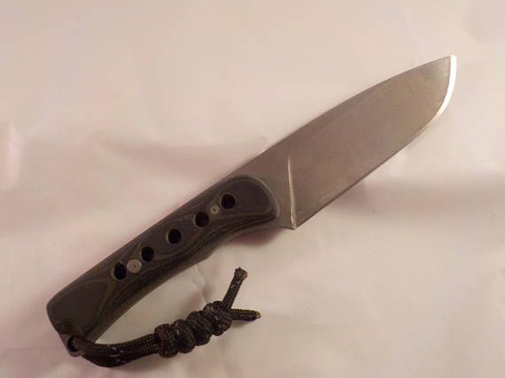

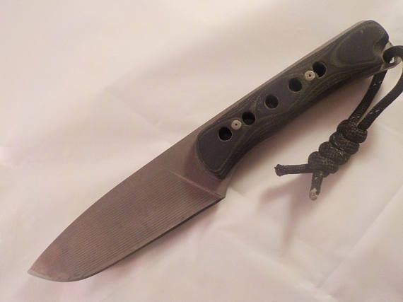

I'm stoked on this one
8" OAL

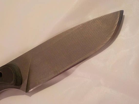

4" Blade
3/16" thick
High Flat Grind

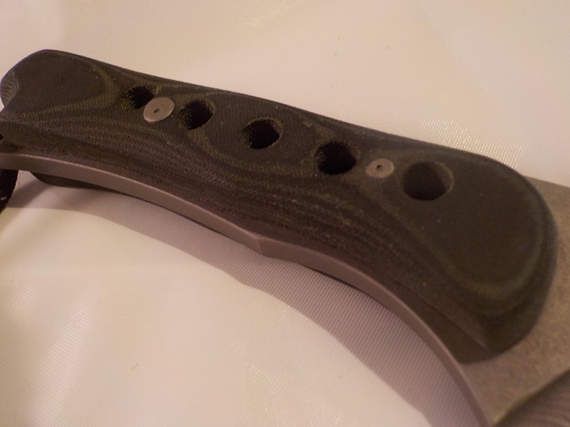

Black/Green Linen Micarta handles with Stainless Steel pins
Designed for hiking, hunting, camping, and general outdoor use. The tip was machined with a thicker profile allowing it to be a bit tougher than other knives with a high or full flat grind. While there is some loss in penetration depth while stabbing, it is almost negligible. I decided to go with a thicker tip after hearing a friend mention, when he skins deer, he needs to break into the pelvis without fearing a broken tip.
Quick video "field test" here - https://www.youtube.com/watch?v=MYBNYib-Zk4
