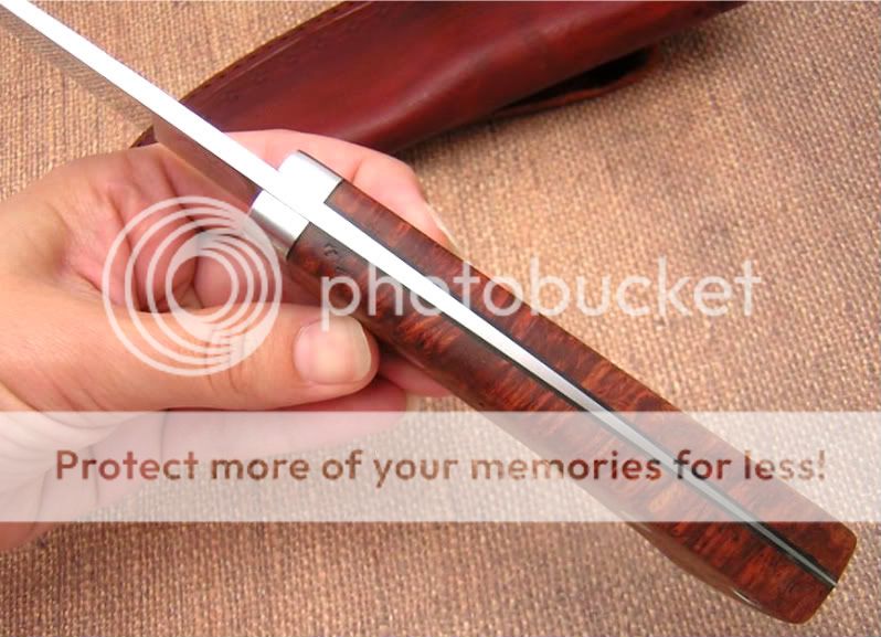

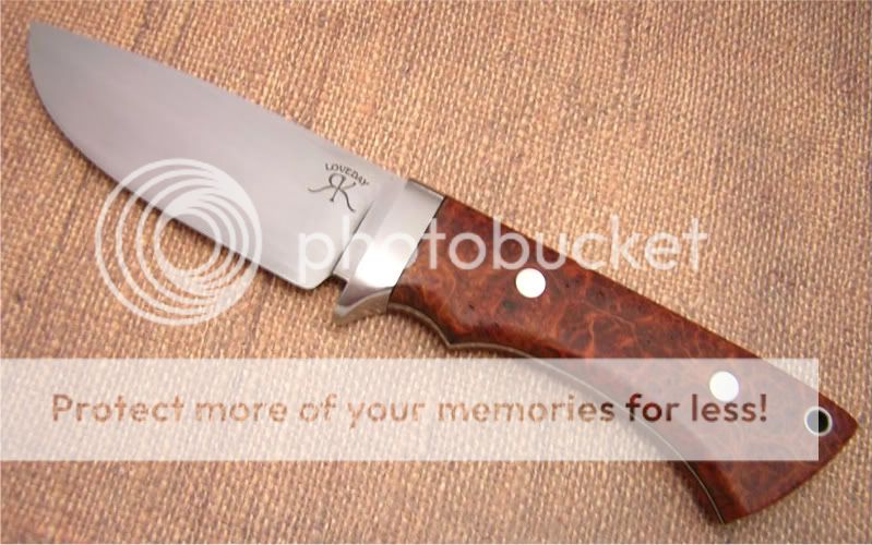

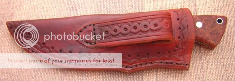

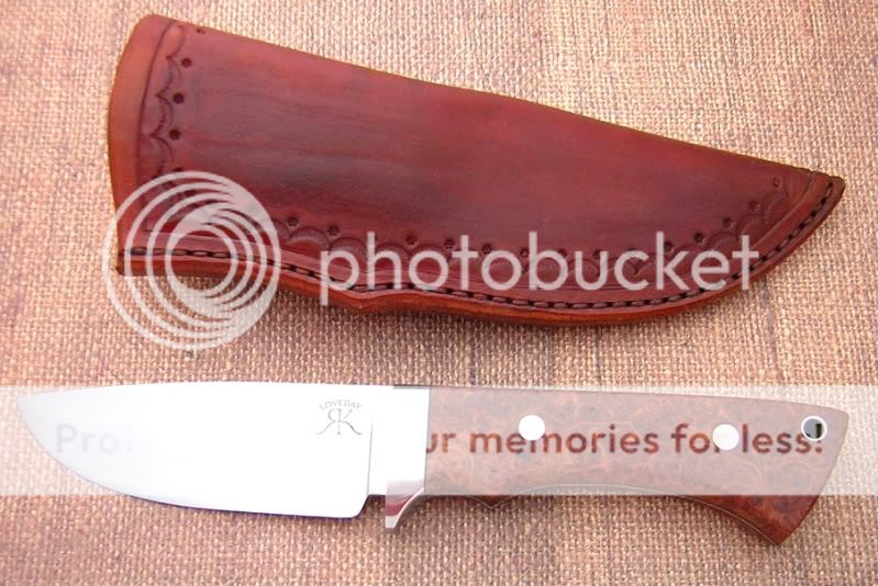

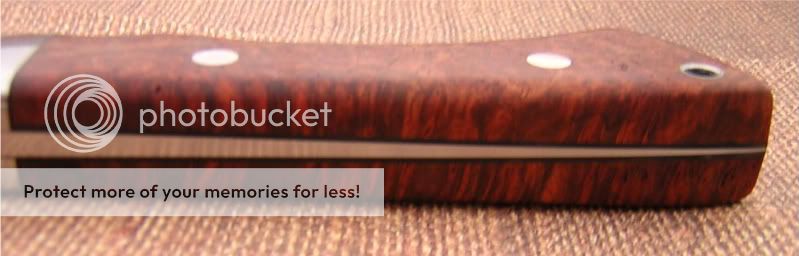

Here's one that I just finished with a full tapered tang.
Blade: cpm 154
Blade length: 4"
Overall length 8.5"
Guard, bolts, and lanyard tube: stainless steel
Handle: stabilized amboyna burl with black vulcanized spacers.
Just in case some of you are thinking that I have sissy hands, that was my wife holding the knife in the last picture.
