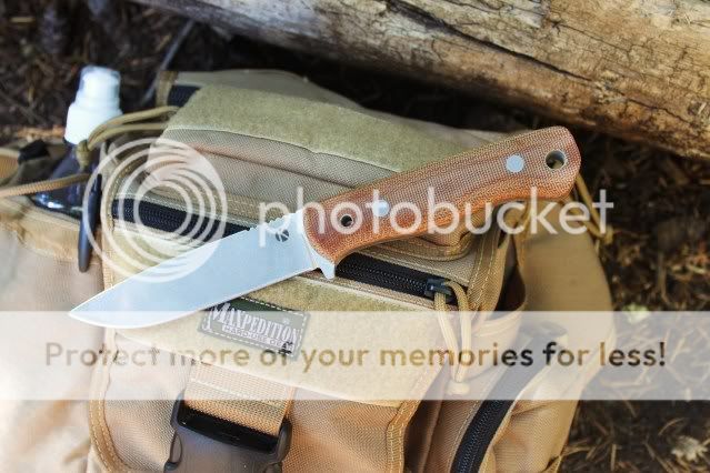

The only experience I have with 3V is in a knife made by Dan Koster. I recently used this knife to cut fiberglass insulation.
I was not impressed with the edge holding capability of this steel for this particular task. It was outperformed by knives with VG10 and M4. I had to sharpen the 3V after every cut.
Andy
I have the same Koster. I love the knife for outdoors bushcraft, which it was designed for. Diamonds are the way to do for sharpening. Ceramic rods are no match for this steel.
3V is easier to sharpen than S30V .I find S30V is best handled with a diamond rod. Both are exceptional steels in use , especially 3V as a chopper and S30V as a slicer.Get one of each !
