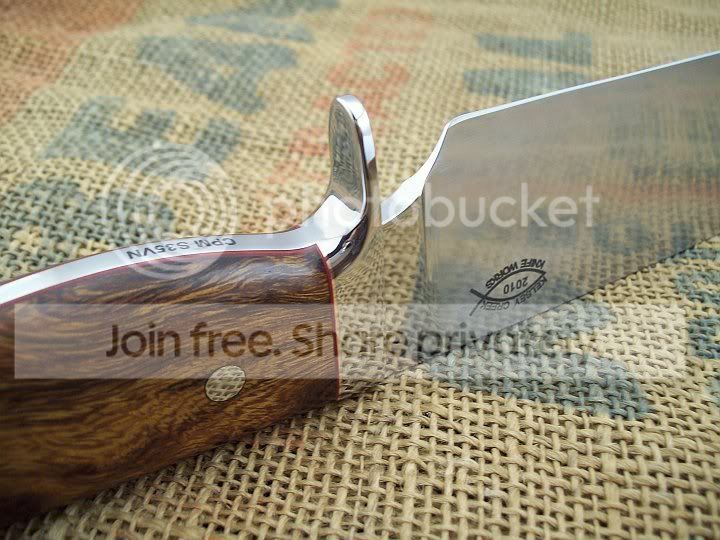

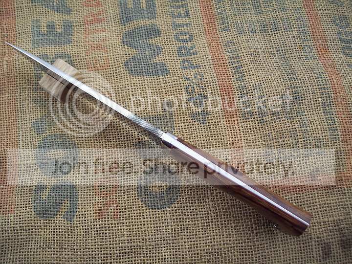

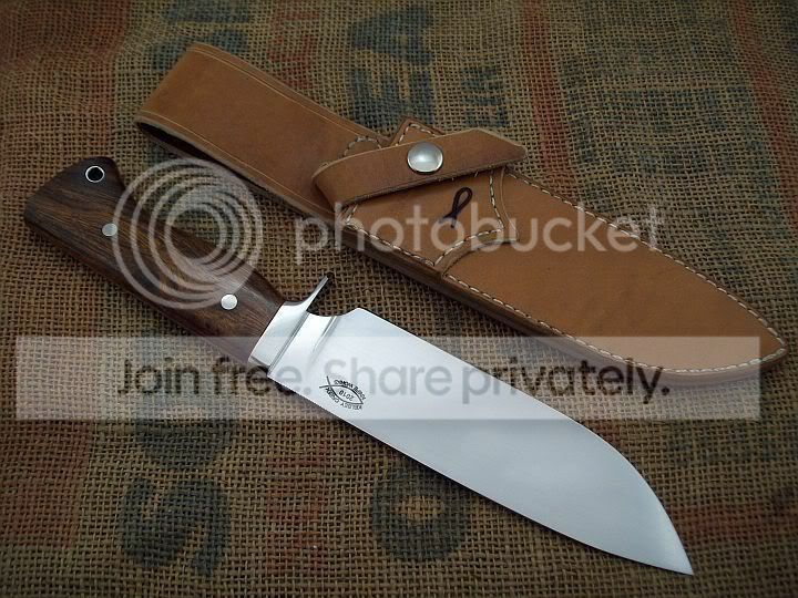

Here's a couple pics of the knife I made. This was to be a "user", so what you see is a 320 grit finish.
Nice work!:thumbup: I've got some S35VN coming this week. I hope it's easier to grind than CPM-M4! Jeez! I'm going through Blazes like water...it's killing me in belt costs.
It seems a lot easier to grind than M4. I have only used M4 one time and I was the same way as you about the belts. David you did a great job on that knife. It looks like it has a finer finish than 320.
