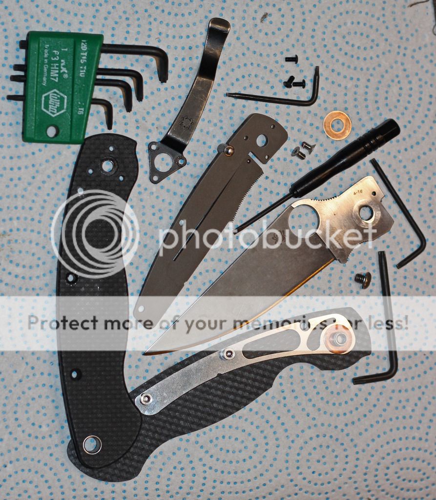

So I haven't taken one of the Millie's with the cqi improvements apart yet but I see that many people have. my question is about the stop pin - how do you get it out? And also is the lanyard tube as big a pain in the ass as on the paramilitary 2
On my 52100 the stop pin is shouldered, nested in the liners, sandwiched between the scales.
Remove all screws, pivot & blade.
Pry the scales apart enough for one side to clear the stop pin.
Swivel the scales on the lanyard tube into a V shape.
The tube is flared so I don't bother removing it.
