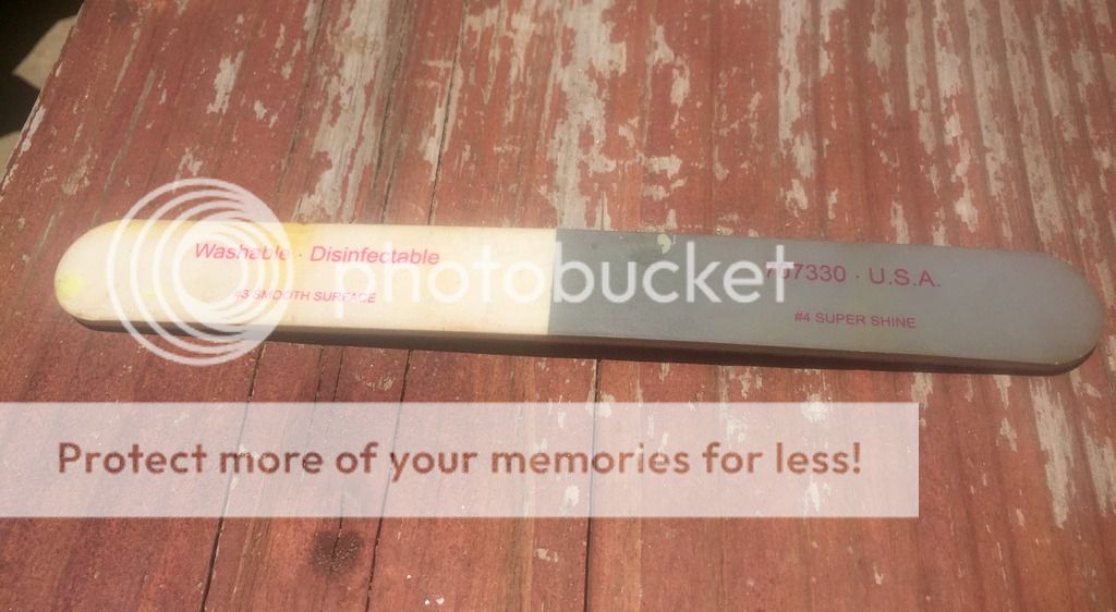

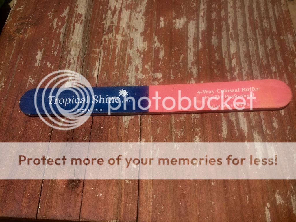

I was recently changing from pants into shorts and my TC which was in a soft thin leather slip fell from my pocket onto the concrete floor and chipped. I was really happy that it didn't crack at the pin but definitely wanted to fix the chip so it didn't snag things or get worse and of course I wanted it to still look good.
I got out some needle point super glue and carefully filled the chip. I let the knife sit on a shelf for 24 hours to make sure it was fully cured. Now I originally had planned on using the same process that you would use for wood, ceramic or automotive and that was to step sand with various grits until I was happy with the results. Pretty straight forward but not all that easy on a small chip in a jigged bone handle.
My wife saw me struggling to sand the small surfaces and angles with folded paper and made an excellent suggestion. About 11 years ago she was a cosmetologist and she learned how to do acrylic nails. She told me that people doing nails are looking for the same effect which is a clean, clear and buffed finish.
I took the 4-way colossal buffer which is designed for strange angles and small objects and followed the numbered steps.
1. Files the edge
2. Removes ridges
3. Smooth surface
4. Super shine
The results were outstanding. The finished glue was smooth and crystal clear revealing the colors underneath turning what was initially a real downer into a nice, clean surface. I hope this is helpful and highly recommend trying out the buffer, she has told me they are very inexpensive.
