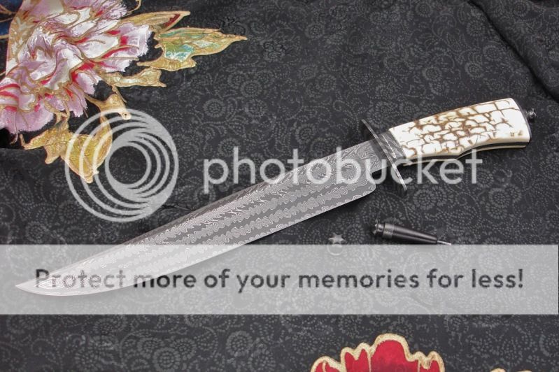

Sent some photos of my Mammoth stash to this client, and he picked a beautiful golden crackle.
He asked for a big, frame-handled Damascus Bowie to show it off.

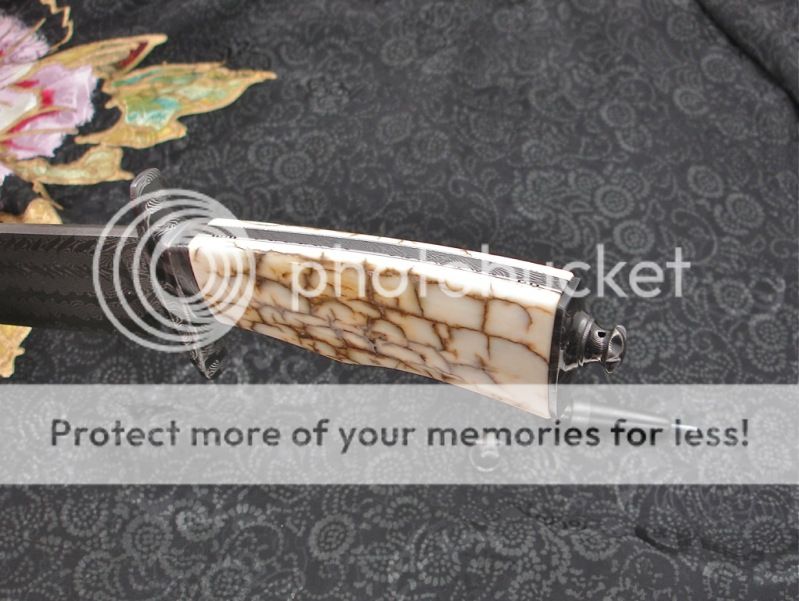

Here it is; 11 inches of a 4-bar twisted Mosaic I think I'll call "Rosebud." The fittings are of a complimentary black and silver Damascus, and the spacers and frame liners are teeny file-worked stainless.
It's a take-down, and as usual, the Damascus-topped take-down tool holds spare assembly pins, and there's a Damascus stud to go on the sheath that Paul Long will be making. (pics on that later)
Here's a few photos.

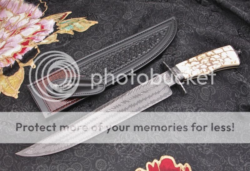

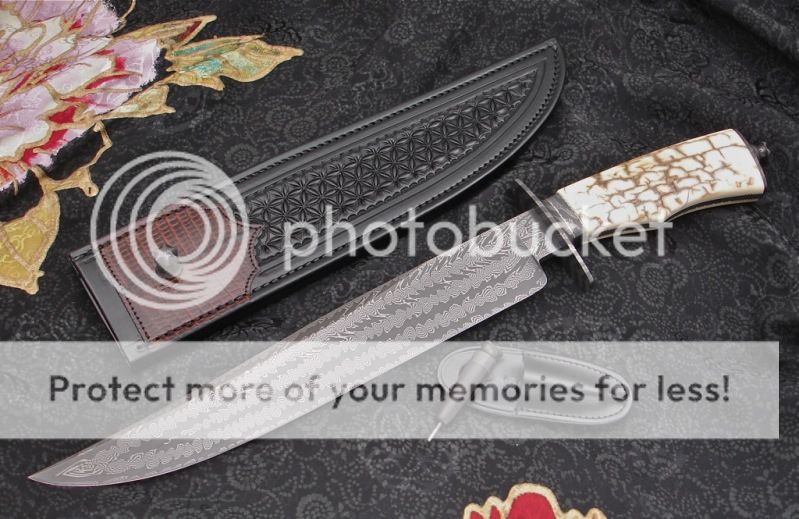

I've added the photos of Paul Long's fantastic sheath for this one.
The overlay is a Golden Lizard to accent the Mammoth Crackle, and the tooling carries out the "Rosebud" theme of the blade's Damascus.
Paul's original "papoose" holds the Damascus tipped "Take-down" tool.
Paul done it proud!

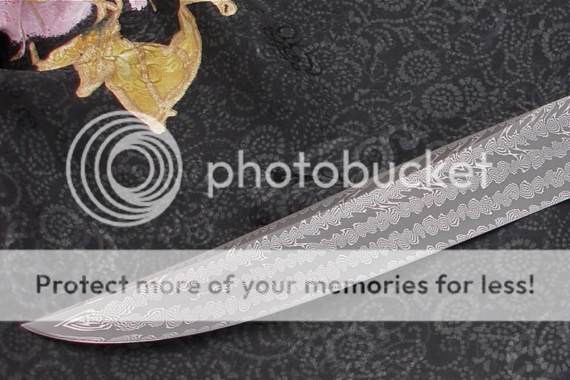

Another inspiring piece of work. Really impressive damascus. I love how the pattern ends just before the tip. Great stuff.

Thanks guys, for the comments. This damascus pattern, by the way, came out of a confab with Shawn McIntyre last June in my shop. Thanks, Shawn.
Gary, I've had some unfortunate incidents with the bird's-mouth method. I do a double weld, cutting an inside curve, and bending. That way, I can match the pattern exactly, and get a good weld consistently.
