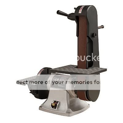

HOwdy! I'm considering moving on up from draw filing for grinding in the bevels. Is the $129 Craftsman 2x42 w/ 2/3hp adequate for the hobbyist? Is it adequate period? Using files is wearing me out but I can't jump in on a KMG just yet.
Alot of guys start out with a grinder like that..It will profile blades and flat grind them, I would get a ceramic platen liner for it (+/-12$).The main problem may be getting quality belts in 2x42..Don't use the ones from sears or home depot..Try true grit they have a great selection of belts online. Get the best butt spliced zirconia or ceramic belts that they have, it will make a huge difference...Good luck.

I got mine as a last floor model. It has been a good purchase but it really runs too fast! It will burn epoxy pretty quickly, as well as wood and micarta.

If you are burning anything eg:wood, micarta, epoxy it is more likely due to using a wore out belt and pushing too hard...Use a fresh sharp belt and it should cut aggressively with out burning...:thumbup:

I have one of the older models and I really like mine And it has met all of my expectations for a low cost belt/disc sander.
Mine is configured differently than the new one and I think that has at least one advantage while the new one has another advantage… Photos of mine follow…
A friend has the new one so I have compared both!!!
Click on the above photo to see an enlarged photo…
These photos show a jig I built to allow me sharpen my knives at a uniform angle through out the length of the edge… But that’s another story…
Notice the different shape of my belt sander; it is a 3-wheeler, where the new one is a 2-wheeler. Mine sits deeper while the new one sits higher…
But the big difference that I see that affects knifemaking is that when making a tapered tang, I can hold my knife by the blade tip and sand the tang, on the new one, the guard on top of the new sander would prevent this. So, if you can’t “dangle” the blade onto the belt, and you aren’t going to make any distal tapers…
Next, I did not check my friend’s machine for this but what about “slack belt” use for shaping handles. Can the platen be removed and how much room is there to work; all very important!!!
However, on the plus side, the new ones have a longer front and therefore; a longer platen. I can only flat sand the bark (scale) off a 10” blade, while the new ones probably allow up to 15” of blade…
Finally of a lesser point, but maybe very important; the new one does not have any dust collection system. Any thing coming off the belt will be thrown onto the bench top; be it hot steel or sawdust…
My friend was grinding steel and the hot sparks burned the bench top, it did not catch fire, but the wooden top started to “glow” from the wood embers…
And dust, it’s God Awful!!! The old one’s have a dust collection system and hook-ups for a vacuum and if you could compare with and without a vacuum running, you would know the difference. If you are going to be working in an enclosed space, such as a garage or workshop, the dust will cover EVERYTHING!!!
All other things being equal, I love the disk and it’s of tremendous use, especially in sanding small pieces like the guards and since the table tilts, you can easily make dado joint on your guards…

The only problem I’ve had with mine was the bearings on the “free wheels (I have two free wheels)” wore out. I have thousands of hours on mine (bought it 6 years ago…) so it did not surprise me that they wore out. Sears wanted about $15 a bearing ($60 total…) and would have to send the sander away… I bought the bearings from a machine shop supplier for $3 a bearing ($12 total…) and replaced them myself in an hour…

I own one. It was a big step UP from the little 1 x 30 and it made enough knives to pay for itself many times over. I only use the disc sander part now.
You will be happy with it for long enough - and you will want more soon enough. I would classify it as a good stepping stone. The quality is marginal but it's worth what you pay for it. The only failure I had was the motor start capacitor blew. Sears wanted $65 for the part. Radio shack wanted $8.
