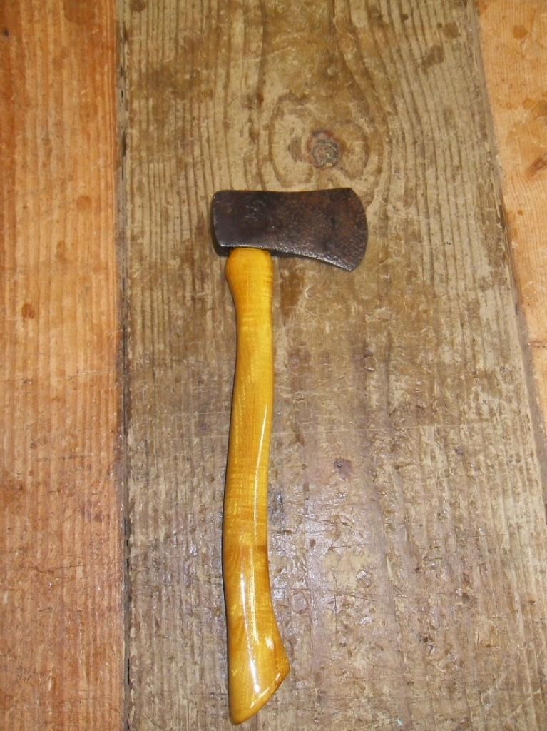

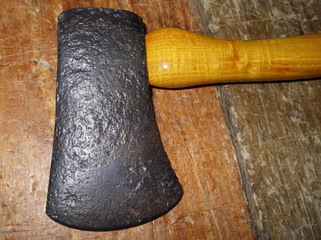

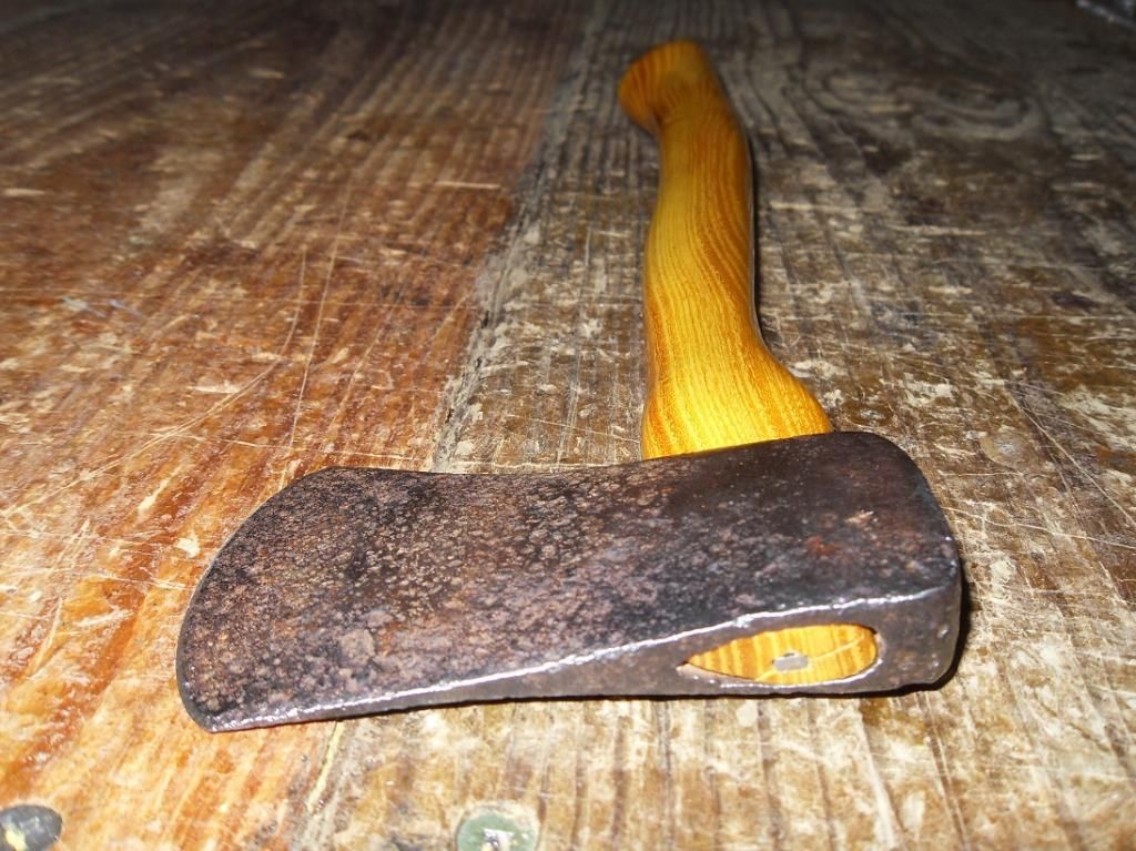

I found this Craftsman mini hatchet head in my Grandfathers tool shed when we were tearing it down. He passed away over 20 years ago. The hatchet head is in rough shape with a lot of pitting. I cleaned it up the best I could with a brass wire brush wheel. I found a picture online of the hatchet with the original handle. I used some curly osage and made a new one matching the shape the best that I could. I finished it with 6 coats of tru-oil. I'm giving it to a friends son. He is just shy of 3 years old so its going to be more for display. This was the first time I have messed with any restore work on a hatchet. I'm a beginner with this stuff so any constructive criticism is welcome. I should have done something different with the wedge.

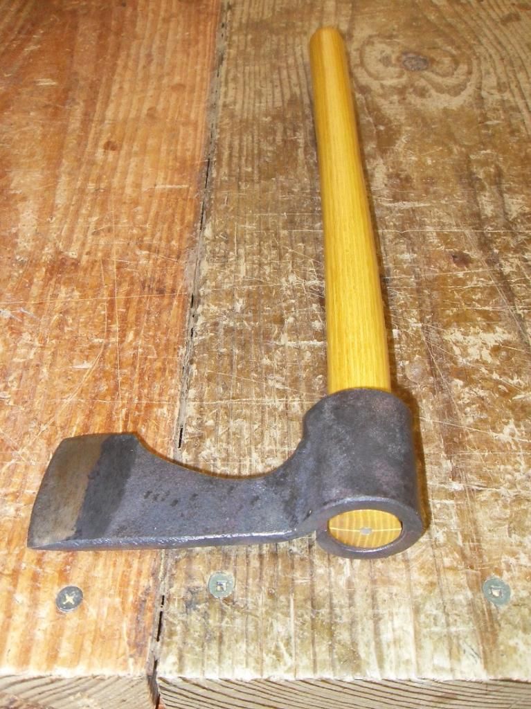

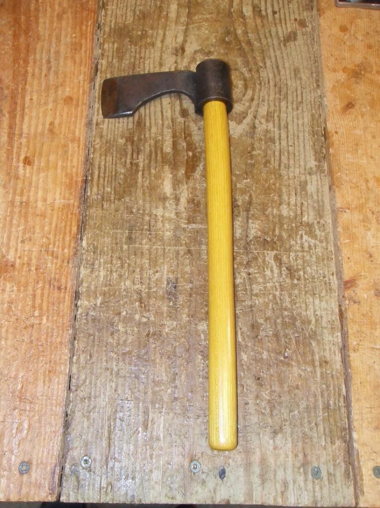

I also made a new osage handle for this throwing hawk. I'm giving it to my friends other son. He is a teenager and likes to throw hatchets at the primitive archery gatherings that we go to. I traded for the head a few years ago. Its made from an old leaf spring. Its finished with several coats of spray polyurethane and tung oil.

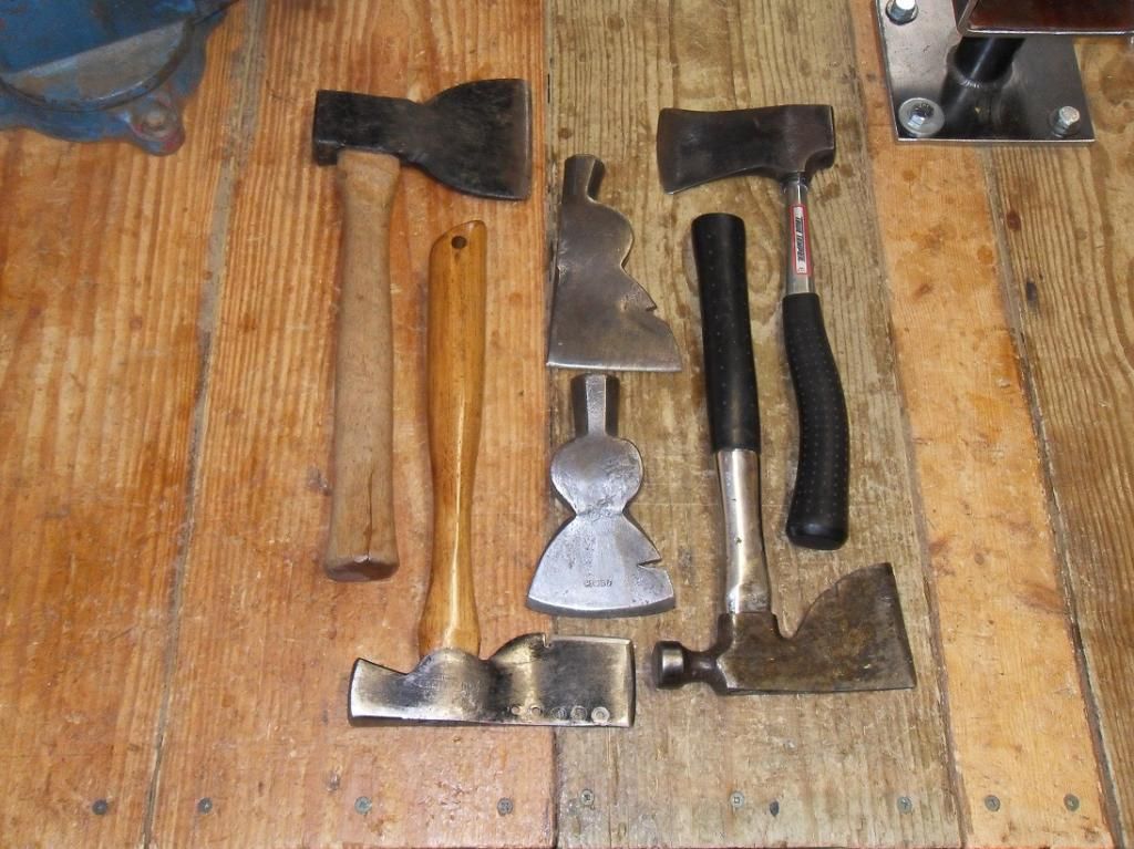

Here is my small hatchet collection so far. I have always loved using hatchets and just got into collecting them this winter. I'll be making new handles for the two heads soon.

So....I agree with regard to the wedge. Fix it when the kid is old enough to use it, I guess. The head is rough, but only visually, I'm sure that it will be a fine user. But the handle...
"I'm only a beginner" he says. To axes maybe. Certainly not to working with wood. That hatchet handle is like looking at axe porn. Bravo.
Nice work. The wedge might be unsafe for using. The wood working and finish is light years of anything I could do though. Beautiful gift.
You definitely are talented with wood! Nice job of the shaping. I suspect that both the hawk and the hatchet can be disassembled without too much grief. You really don't want either head to ever fly off. The hatchet should have a kerf cut into it and a taper wedge installed. If this doesn't have any appeal (ie trying to take it apart) it is much simpler to just pound a conventional steel wedge in there or better yet see if you can get hold of one of those now-popular hollow cone-shaped metal wedges that many European axes feature. Hawks are generally slip fit like a pickaxe or a mattock and therefore have no wedge at all. Does yours have a noticeably tapered eye (front larger than the back)! If not, with a dremel tool or a small grind stone on a drill you could also make a small eye flair so that a kerf and wedge can hold the head in place. A hawk haft with no shoulder is going to be problematic though (head can slip off towards the back) if wedging is in the cards.

I will point out that with handles for hatchets, hammers and so on it is widely accepted that the grain should run as close to parallel to the business ends of the tool. I wouldn't worry about it in these cases, but something to keep in mind for the future.

+1. Now that I see you're a bow maker, it makes sense why you went with this grain orientation, but like Hacked said, it would be better to turn it 90 degrees so the grain is lined up with the cutting edge. Probably won't be an issue on such a small hatchet though.

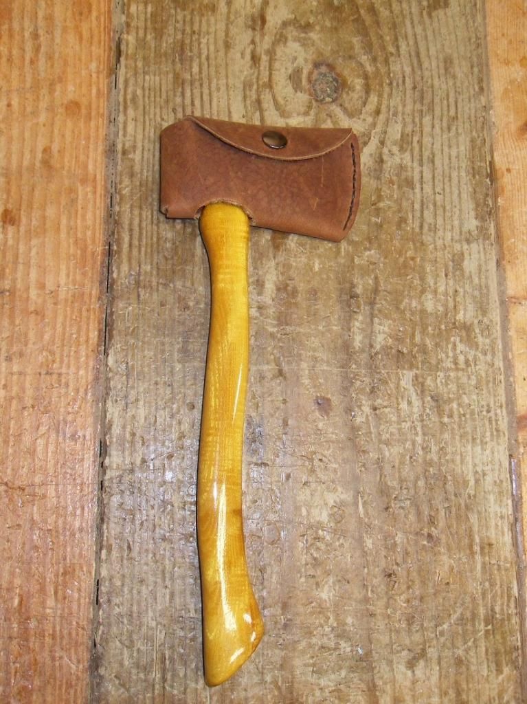

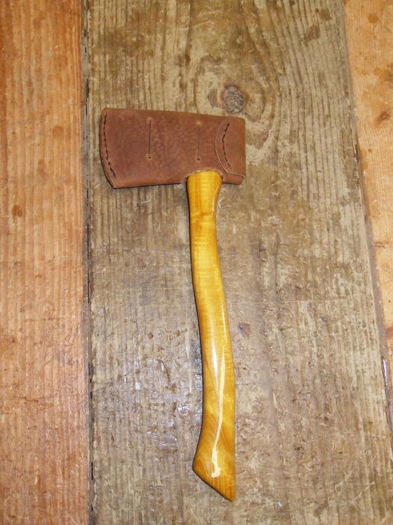

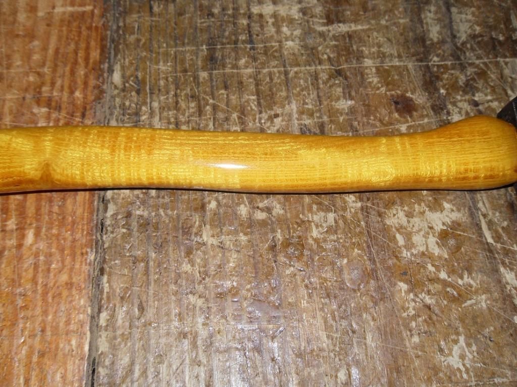

As long as you're starting from scratch, don't be afraid to deviate from the shape of the original handle. Factories in the last several decades especially seem to shape handles based as much on minimizing waste, and ease of cutting them from a flat board, as they do for user comfort. Yours turned out right pretty though.

Their is no taper to the eye on the hawk. I don't think I can take these apart without messing them up. The head fit very snug on the hatchet. I had to do some pounding to get it seated. I took a ring shanked nail and hammered it flat and into a tiny wedge shape. The edges of the wedge still had the rings so it was kind of barbed looking. I used the same type of nail on the hawk. I cut it to about an inch long and didn't flatten it.
I knew the grain orientation wasn't ideal for both of them. I wanted to cut the handle out of a highly figured osage board. I couldn't get the shape that I wanted with the grain running the right direction. With it being such a small hatchet I didn't think it would hurt anything. The handle on the hawk had a slight curve to it. I turned it so it would curve forward instead of sideways. I harvest a lot of osage for bow making and I'm very familiar with its strength. I'll make sure the grain is correct on any tools that will see some serious use.

I can't imagine a better handle material than Osage. I would think you could easily make your handles as thin as you wished and disregard most rules that would apply to lesser wood. As long as there was not a lot of grain run out near the head it would be pretty dang hard to break.
I agree with you on the osage handles. From my experience bending it I know how much thickness and width it takes before it starts to flex.
