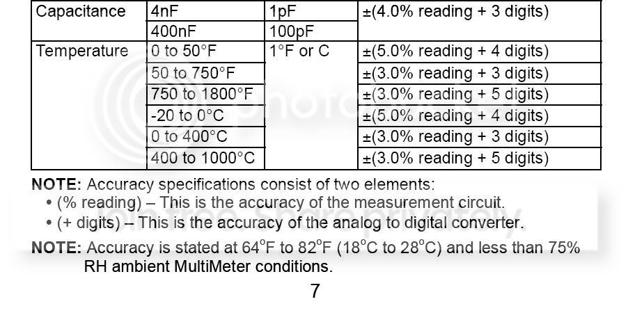

Took a walk in the tool section of sears tonight. They have a volt meter there that comes with a thermocouple. On the package it states that it will read temps up to 1800 deg F.If I'm going to spend about $70 to $90 for a pyrometer, I figured why not get a multimeter that takes temps too. The price is better too. Below are links to the item and the users manual. The temp chart is on page 7
I probably won't be going the route of the automated PID controller. I was thinking of just a pyrometer. So what are your opinions of using a volt meter like this one for taking temps inside the forge?

Just a point to consider....
the allowed variance works out to a 90 degree swing at 1500F. That will be a bit tough if you are trying to keep a 1450 HT zeroed in. It could be 1405 or 1495, but the meter could say 1450.
