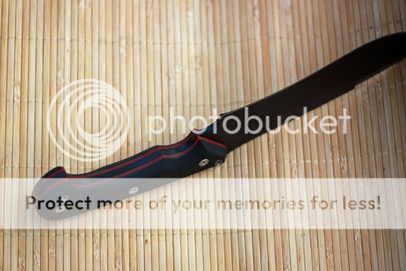

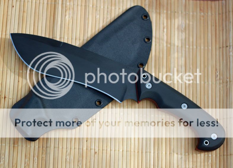

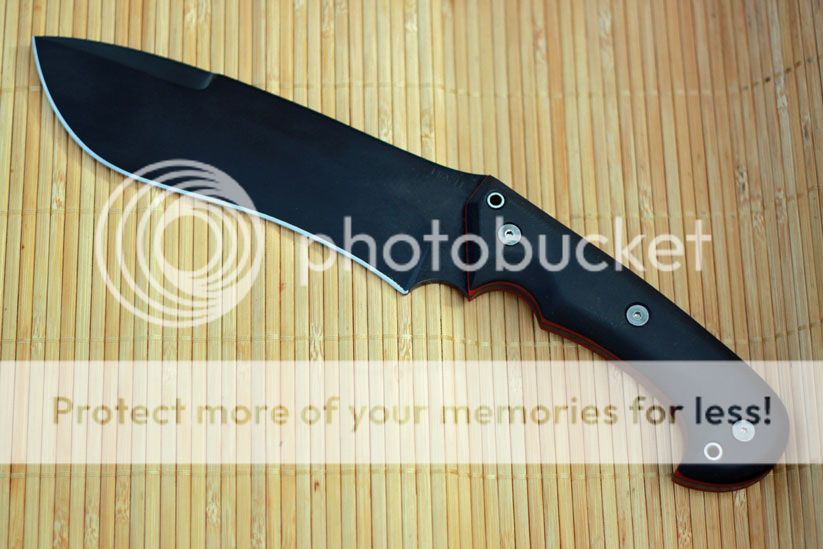

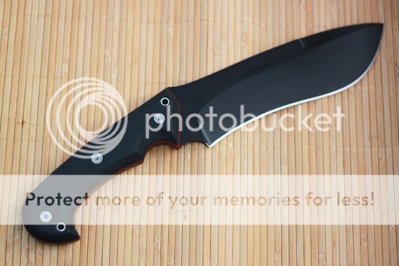

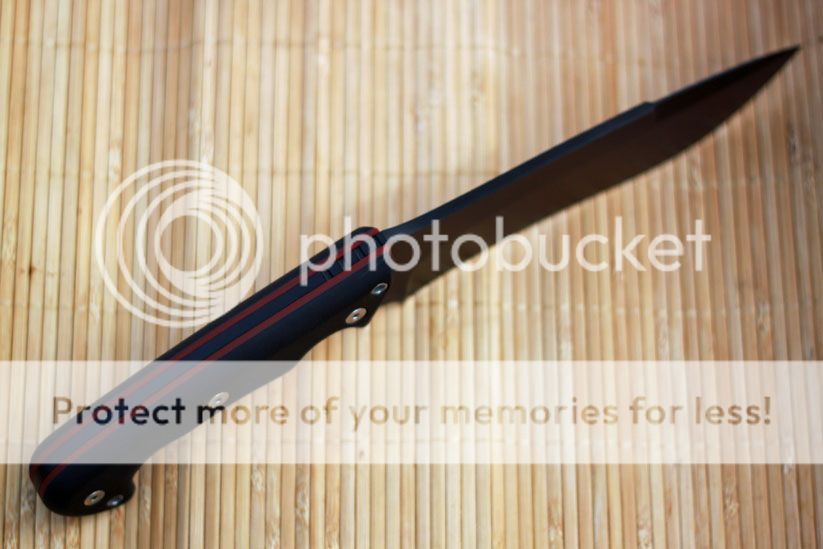

I finally finished this one up for a customer in Australia. It took me a good long time due to schedule/life etc.
Model- BEEK
Steel- N690 at 60 Rc
Thickness- .197 or so
Blade length 6.75"
Overall- 12.375'
Handles- Red G10 .090 liner, black G10 handles, SS screws and tubing.
Coating- Cerakote in graphite black.
This is one of my favorite big knives. The original design came from a template that Todd Begg let me use (Preacher's bowie). I have modified the handles and changed the blade shape a bit over the last couple of years. I would like to think that his influence is a positive thing. Just have to give credit where credit is due. Thanks to Todd and his constructive criticism I have improved greatly over the time that I have known him.
Thoughts? Dan
Holy moley, that's a winner I reckon. Love the whole look of it. The handle is just what I like in a swinger too. The only thing that I would question is the swedge. Wouldnt you want as much weight up front as possible in a chopper?
What use will he put it to?
Whatever he wants! He is a collector of fixed blades so I don't know if he "plays" with his knives or safe queens them. It is his knife so....
He is a member here so maybe he will pipe in.
It still has a lot of forward weight. Not that much weight taken off for a swedge but it sure makes it cut better at the tip.
Plus it looks cooler!
