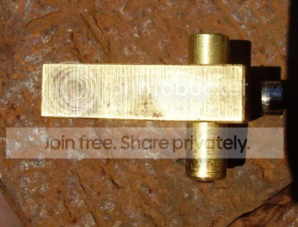

I use this easy to make edge scribe.
Bob

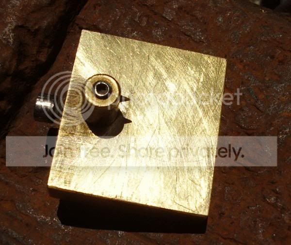

I made this scriber thingy with a block of alluminium and using some old drill bits.
It's easy.
I can do everything in micrometric steps. Just set up the height, lying all on a glass plate, scribing is easy and effective.
By the way the use of drill bit alon of the same thickness or slightly smaller is the trick that cannot fail. I use it a lot before.
