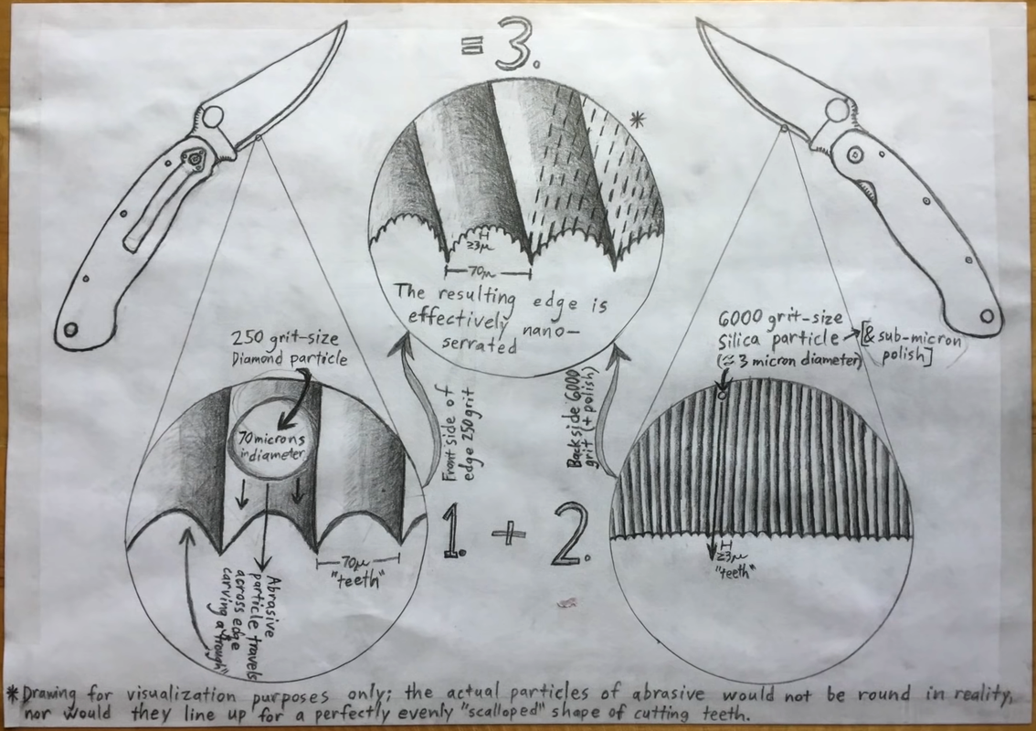

Can you get a super toothy edge by using a super gritty stone, say 80grit to 320grit, then jump to say a high-end totally flat stone say 2000microns to 6000microns to achieve a kinda microscopic serration in a blade edge??? So you get the best of both worlds?
I think so. What I've done is: achieve the apex and go through the grit progression only as much as you need. Test, does it grab paper immediately and cut S curves smoothly? If so, you know you have a proper apex. Then, use your 320 again, sparingly, like 2-3 passes.

My favorite toothy-style edge, so far, is made by using a XC/C diamond (220/325, either by preference) to set the bevels and apex the edge, then applying a very minimal, barely-there microbevel with a medium or fine Spyderco ceramic in 2 passes or less per side at a very light touch. I use my Spyderco Sharpmaker to do the microbevel, sometimes at 30° inclusive or sometimes 40° inclusive, whichever seems to leave the apex more stable for the steel type & hardness. The concept in mind, when I do this, is to narrow the apex width with the microbevel applied by the ceramic, while also doing some additional deburring of the apex. It makes for a very stable and wickedly aggressive slicing edge.

Pete's (Cedric & Ada) friend is making these edges:
