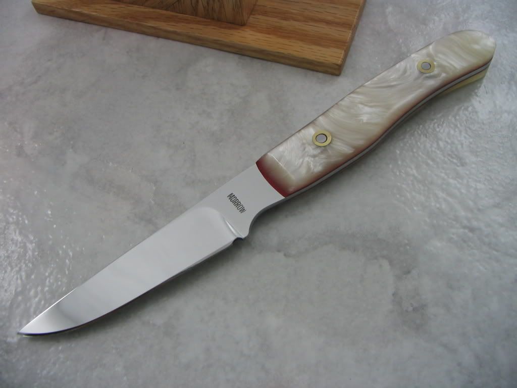

!st one is a paring knife. 3 3/4" blade .093" 440c 61 rc oal 7 5/8".
poly pearl handle, red liners. Oak knife block.

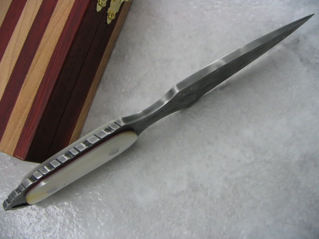

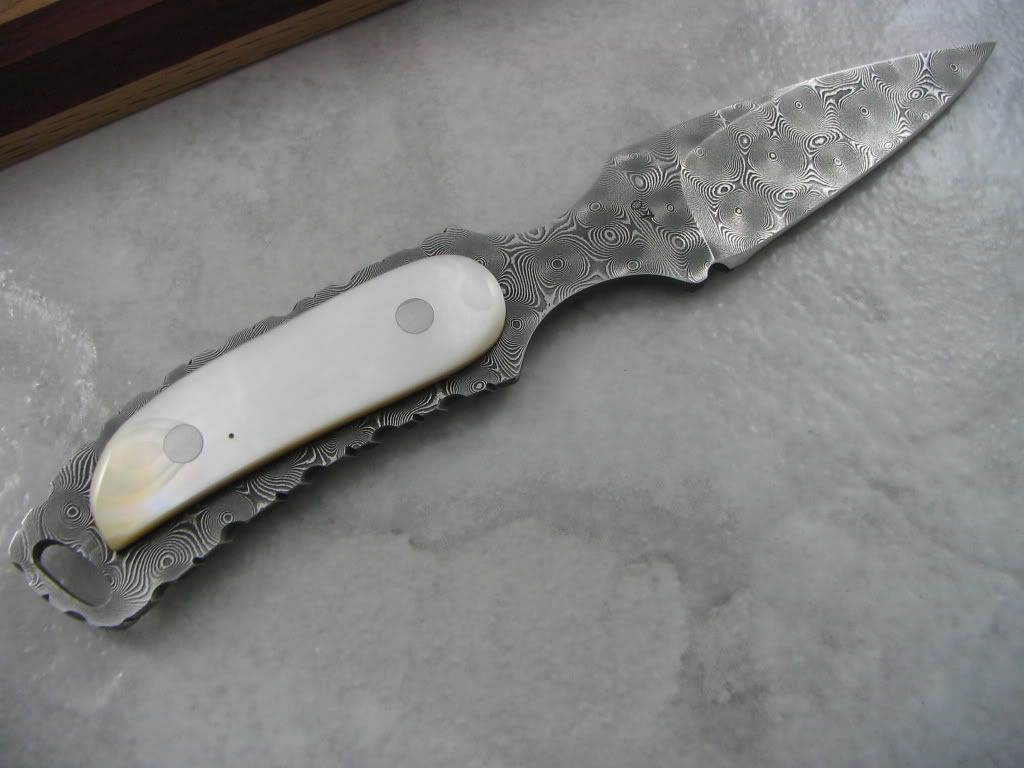

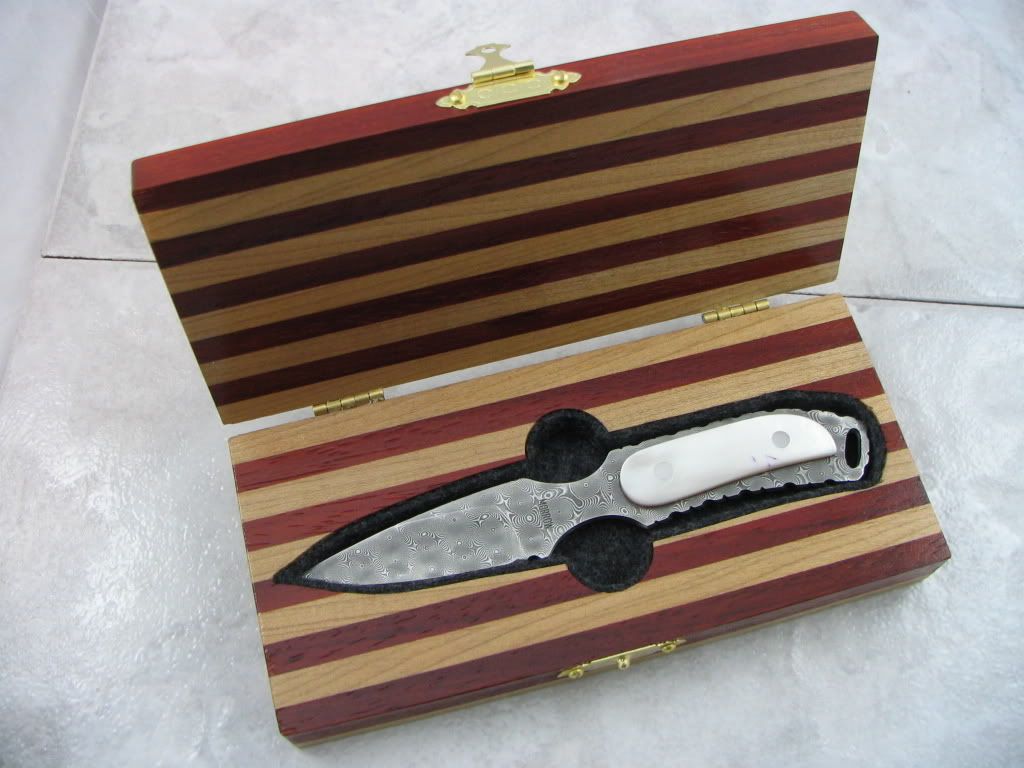

#3 is a little mop handled sticker. 2 5/8" blade of Devon Thomas s.s. Damascus. 60 rc. File worked tang with stainless bolts. (the pin holes in the pearl didnt show up till after it was together #$%&*!) The box is made of paduk and poplar with an oak bottom. Hope you like em.
