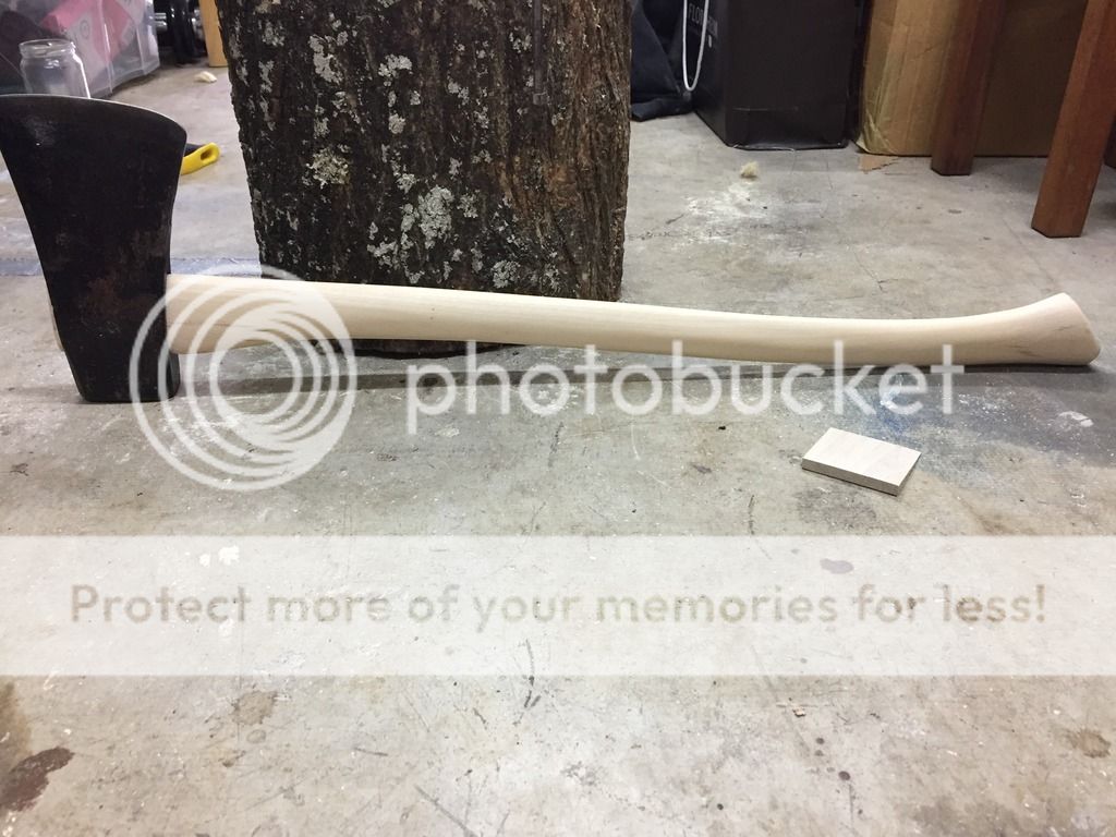

Just wanted to get some critique on my current project. I replaced the handle on one of my favorite heads about a week ago now and the knob on the end of the handle just wasn't quite pronounced enough for use with thicker gloves on. I have maybe 8-9hrs worth of work time on it since I put the new handle on. This evening I set out to change up the handle a bit. Shaved off a little bit up near the head also. Seemed to be a thick. Did everything with a rasp and sanded it down afterwards. Then coated it with BLO.
What I wanted everyone to critique and give their opinion on was what I maybe did wrong or could have done differently to achieve a better end result. Maybe post up a picture of one of your projects or a pic of one you thought was executed near perfectly. If you think it's a job well done just let me know. Always open to critique from the experts or others with more experience than myself.

Overall I'd call it a very good hang. As far as 'open hang'/'closed hang' it looks just right. I like how you've captured the little finger far enough forward that the end of the swell won't blister the heel of your hand. Both the bit and poll of the axe look unabused and in good shape.
I can make some suggestions but these are really minor little nitpicky things hardly worth mentioning. You could have taken a hair more off the shoulder on the poll side. It's not a Quasimodo my any means. Just barely more hump than needed.
In the top down shot:
I don't really care for round wedges. I prefer just wood wedges. I'll add a flat steel wedge if needed later. Most of my axes have no steel wedges.
Also in the top down shot the bit appears to curl toward the right. If that's real and not just a photo artifact then I would straighten that edge with a file.
In the last photo of the poll the shoulders seem a tiny bit wide. They might get scarred in the split.
Again, these are all extremely minor. I'd be please to use that axe just as it is. I only mention these things because you asked.
@Square_peg Thank you for your honesty and the kind words. Good to hear even the nitpicky things. I trimmed the shoulders down a decent bit. Might do so again after letting this BLO dry and getting out to use her a bit. I thought the shoulders were still a little wide. I also just recently started using these round wedges. Not sure if I'm a fan yet either. They will have to prove themselves over time and after a many of hour of use. I've never had problems with wooden wedges but where I live I can't find any black walnut or much of any other type of wedge besides oak. Then the wedges from Lowe's but that is about it. Do you know of anywhere online that has decent wedges? Also the bit does indeed curve right. Not as bad as the chili peppers I hit while playing golf but it does curve. I do believe I will have to trim the shoulders to keep any scarring from happening though. I appreciate your quick reply too.

Except for the best fitting gloves I can't use an axe with gloves on ... I hate working in gloves in general, but I'm just saying, it may not be the handle's fault, it may just be personal preference. In any case, thinning the handle is a good move IMO, but the issue with the swell with most new handles I encounter is that you'd have to add wood to improve them. That was a pretty good looking handle, if a little thick of course, but probably much of the original swell was left as dust on the factory floor. Another option with wedges, and how I make mine, is to just split them out a little thick, then belt sand (or whatever) them to the desired shape.
Good job. Looks wonderfully usable to me! Store bought handles these days are so club-like crude that concerted efforts to thin out and make the handle more comfortable is a real plus. Your selection of handle with regard to optimal grain orientation (least possible runout) looks to be 'bang on'. If the hang does accidentally work loose through shrinkage you're going to regret having installed that hollow conical wedge!
Over the past few years there's been increasing agreement on here about the benefits of trimming handles somewhat proud of the eye (1/4", tops) rather than flush cut such as on factory hangs. One) it allows the uncompressed wood and wedge to 'swell over' as cheap insurance against a head flying off and Two) it enables future whittling to expose wedges to pliers or vice-grips should there ever be a need.

@300six thank you for the honesty and critique. I've never used these round wedges before and I think with the lack of adjustment is going to come back and bite me. I saw them in my local shop so I thought I'd give them a try for $0.79. A cheap experiment but could be more expensive if I have to hang the head again if it get loose. Appreciate the kind words on the handle though. I tried to pick a handle that had the least amount of run-out as possible. I have seen the wood swell over on the extra 1/4" sticking out before. It really help the head not work loose after hours of hard use. I don't plan on buying anymore of these round wedges except for maybe hammers or something of the sorts. My next few hangs will be with locust, black walnut, and maybe osage orange wedges from Thrane. Looking forward to getting back to all wooden wedges. They look so much better once you get them sanded and oiled down. Thanks again for your thoughts on the subject and the help.

Looks pretty good to me.
But since you asked, I like a smooth transition from the handle into the eye of the axe. IMO the handle should not be wider or taller than the eye at any point. (well a little is OK, as in a couple mm's each way, nothing abrupt)
The whole shoulder should be thinned down to meet the eye of the axe. In your example I would remove the "hump" from the back of the handle/shoulder, and reduce the side to side thickness (only a little bit) below the eye as well.

@nzedge I really do like that smooth transition. I know I'm not done modifying it yet. Going out and splitting some wood up tomorrow so I'll give it another run with the current mods to see what I do next. Might be shaving down the handle to make a smooth transition.
Got two questions.
Would making it thinner near the eye make the handle any weaker? Still learning a lot about handles.
Also anyone know why pre made handles are thick near the eye? Maybe add looks or strength? Maybe to fool proof it?
