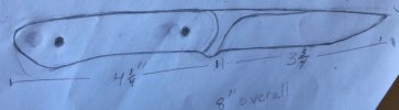

Alright, my first try ever drawing my own knife. It has qualities of about 4 knives I liked the look of. I sort of like the flow of the ricasso area on this one. On the other hand I am not sure of the look of the spine if it is too straight. Also the pins...I think I would like a thong hole, but does one pin and a thong hole work? Should they be place differently?
I have some 1/8" 154CM that I would like to make this out of.
Let me know what needs fixing here please.
Looks good to me, pin placement looks fine. I would advise to, if you like your sketch, cut it out on a piece of cardboard, see how that basic shape feels in the hand. If something is too small or too large or something just feels off, you will notice it better with a template and then you can adjust your design.
Then I would just adivse to go ahead and just make the knife. When it is done and you have handled it and used it, you will notice things you like and things you don't like about your design probably. Then you can adjust your design again and go on from there. This way you better develop your own style.
Everything looks fine to me, and the number of pins are mostly personal preference, but I would change the shape of the finger choil/guard area by giving it more curve by extending it into where the index finger rests a bit further forward, like about 3/8th to 1/2 inch. That "hump" kinda messes with the flow and looks like it could be a bit annoying when holding, but that's just my humble opinion. I would extend the curve enough so that it almost came to a bit of an apex when it meets with the opposing drop on front side of it, but then still slightly round it over as well as lightly chamfer the edges/sides of it for comfort.

one pin and one thong tube will be sufficient. the riccasso looks a bit too long, i would shorten it by 1/4", which will make the blade a tad longer. looking good !

I'm not picturing this very well. I will try a new drawing with what I think you mean.
If I lengthen the blade and recurve the choil area does it fix up what coldsteelburns is saying?

R Randydb . You are almost there, IMHO. The spine should be curved slightly more from where it goes flat in the middle of the handle to the blade tip. The rear pin should be a thong tube, but move it back about 1/8". Center the front pin between top and bottom. Draw a line parallel to the spine thru the center of the front pin all the way to the back. Measure forward along that line from the back of the scale a distance equal to the distance from the center of the front pin to the front of the scale. That will be the center of the back pin. The pins should only be 3/16". If the thong tube looks too close to the pin, move it back a little more and reduce the size to 1/4" with 1/32" wall thickness. I think 1/8" thick is way too much - I would take your thickness down to .07" or .08". I would guess you are cleaning 12" to 15" trout, not 40 lb. salmon.
I think this means that I should have pin/thong tube equal distance from either end. Like both 3/4" from each end. Right? But I hate thong holes in the "middle of a handle". I like them up and to the top corner of my handle. Like this.

Use the metal you have on this one, but 1/8" is pretty thick for a bird and trout knife. Do a full distal taper. I use .090" down to .0650" for B&T blades.
The above suggestions on shape and moving the finger rest are all good.
I would suggest a Corby bolt for the front pin. The thong tube may look cool, but if the user really won't be using a thong., use two Corby bolts and skip the tube. It is just a place to trap all that nasty stuff when cleaning game.
This is my effort after Tim37 input. Dropped the blade tip a bit...moved pins around. But what Stacey says about the thong makes sense too. I just like a thong on my smaller knives because it makes it easier for me to get them out of the sheath a bit quicker. But the reality is that they do collect a lot of crap.
Soooo...if I move to 2 pins (corby's possibly) I should move the pins to equal distance from each end of handle and centred top to bottom of handle right? Like this?
Now you are cooking. 2 pins equidistant from the ends and centered top to bottom. A nice fair curve over the whole length of the spine. I would keep the thong hole where it looks like you erased it - although it may collect crap, it does make it much easier to get out of the sheath. Hope you will show us pics. of the knife - it really looks good.
