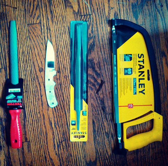

So I recently made my first knife from a Sarge 3.5" Hunter Kit off of Amazon. I really only went this route because I didn't have the required tools to go from raw steel, and wanted to get my feet wet as soon as possible. So I basically did everything I could to test out techniques I'd eventually want to implement when I start working from bar stock. I'd love any notes you guys are willing and able to provide so I can adjust my technique or approach on the next go around - I'm about to pull the trigger on the next batch of supplies, including my first real piece of D2 steel.

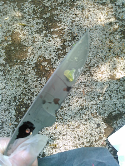

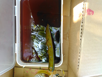

I was initially worried that the acid wash wouldn't take, but those fears were quickly relieved. I flicked the blade with some nail polish, let it dry, and dunked it into PCB etchant from Radio Shack for about 5 minutes. I decided to let it go a little longer.

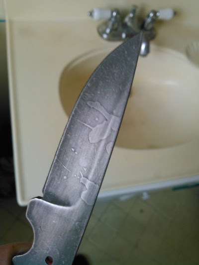

This is what came out:
Nice! But I would be damned if I was gonna have those bright shiny spots jumping out. So I gave it a scrub with some 220 grit sandpaper, then threw it back in.
I couldn't tell you how many times I did some variation on this, sanding, dunking, and wiping, but it was a lot.

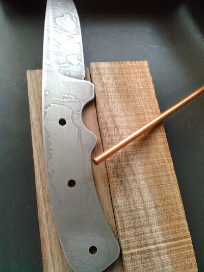

The scales are black walnut purchased off of Amazon that showed up WILDLY mismatched. See Exhibit A:
Assembled my materials, including some nice 5/32" mosaic pinstock.
I didn't have anything but a hacksaw (embarrassingly, I don't even have a workbench set up yet), so I asked my buddy who works construction to cut it out at work.
He did an... OK job. Very obviously did not have a scroll saw. I've since purchased a jigsaw, and will hopefully be buying a bandsaw soon, so I will probably "handle" this stuff myself from here on out.

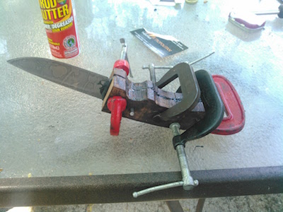

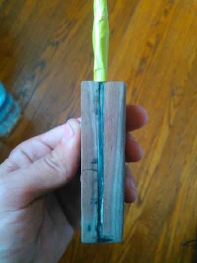

Anyway, I was in a hurry to get going cause I waited roughly two weeks for him to cut em, so I slathered them in JB, worked the pins in like a madman (next time not using 5-minute cure KwikWeld, lesson learned :black_eyed
, and clamped it for all I was worth.

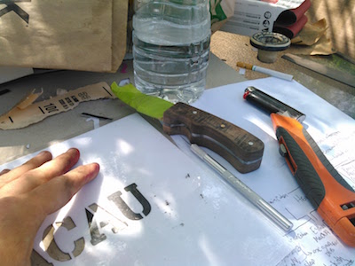

Six hours later, I had this hideous creature (other lesson learned - sand/plane your scales BEFORE you epoxy them on with 2200 PSI weld):

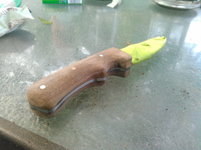

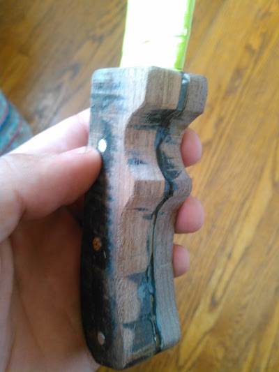

This is the only real "progress" pic I have, but as you can see, I started with the outside "perimeter", shaping it to the profile of the blade.
Then I set about contouring it to my hands, going with whatever felt comfortable and doing my best to remove the 1/16"+ discrepancy between the two sides.

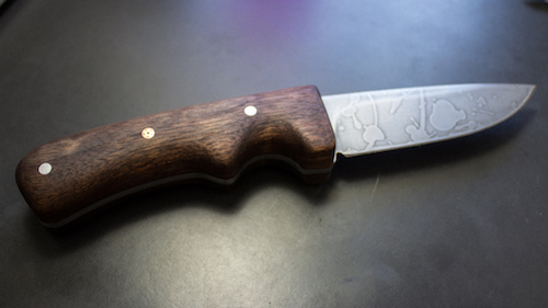

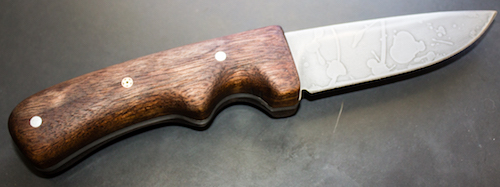

This is what I ultimately came up with:
I hit it all over with some 220 grit sandpaper for the next day or so, getting all the epoxy away from the seams, polishing the metal a bit, and generally smoothing out as best I could. Obviously, I lost whatever acid wash was on the outside of the tang. I did my best to gradate the "smooth" steel to the acid washed as it went up the blade. Then I hit it all over with some 400 grit briefly, but I'm impatient and I wanted to get to finishing. I rubbed it all over with Tung oil, then about 6 hours later, scrubbed it with 220 and 400, then another coat, then 400, then another coat, then 0000 steel wool, and so on and so forth. I wasn't incredibly scientific about this, but at some point I switched to a mix of Tung oil and beeswax, at about a 2:1 ratio. I actually really liked this, as it filled the cells of the open grains much better than had the Tung oil on its own.

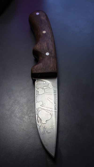

I also gave the blade a few once-overs with 4-600 grit sandpaper, and steel wool to even everything out. Anyway, God bless you if you've read this far. Here's the finished product.
