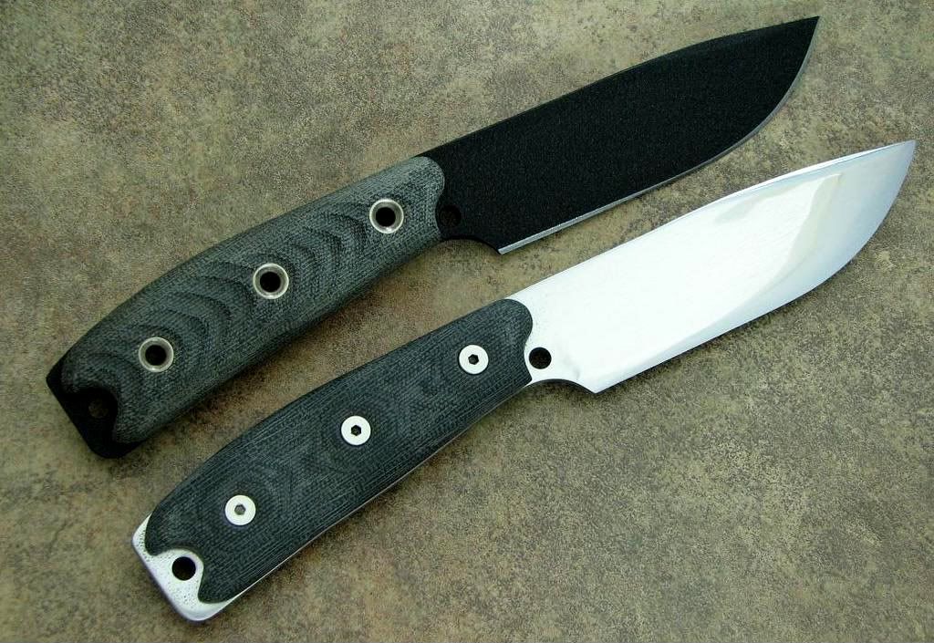

Being "green" have you handled/used knives with very similar design, e.g. Becker Eskabar? I know it's smaller than your design, but the shape is very similar. Slightly larger is the Busse SAR-5 (neither image below is mine).
I've seen more bad jimping than good, so I'd encourage you to focus on other aspects first and figure out the negative and positive aspects of the design, maybe by querying users of the aforementioned knives with similar design.

Regarding the primary bevel-angle, you're thinking about it wrong. Angle is simply a description of the blade's thickness as it tapers from spine to edge. What you need to decide on is how thick you want the blade to be, i.e. how stiff and strong to resist lateral flex at the cost of cutting efficiency. Thin cuts. You mentioned that the spine will be ~1/8" thick, but how thin do you want the knife to be behind the edge, i.e. at the shoulder where the primary bevel meets that 20-degree edge-bevel? The most efficient cutters are <0.010", "hard-use" blades are generally >0.020" for greater durability. Decide what edge-thickness you want on the blade, then decide where you want the primary grind to start near the spine - full-flat or something of a saber-grind, etc. Then simply grind the blade (however wide it may be) so as to maintain the desired bevel-height and so as to achieve the desired edge-thickness. The grind-angle is simply whatever accomplishes that, and you can grind flat or hollow or convex. Remember, it's not the angle that matters, it's the thickness.

I have a Kershaw Echo that is ~1/8" at the spine but is still >0.030" behind the edge, same for some Gerber and Buck knives both folding and fixed, ESEE knives while thicker at the spine are routinely ~0.030" behind the edge - those are heavy edges, nothing thin about them. Conversely, I have blades >0.20" at the spine which achieve ~0.010" behind the edge - better penetration and edge-retention on those - and they feature the same edge-angle for high durability and cutting efficiency up front. You can make a 1/8" blade as thick or thin behind the edge as you desire, just grind it appropriately. Using 1/8" stock means less material needs to be removed to achieve the desired edge-thickness, and it may be easier to achieve an even, well-centered edge that way as well.
