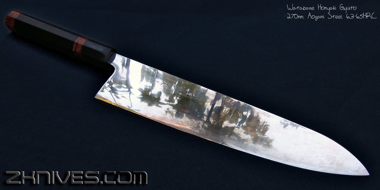

Hey guys preparing to make a Gyuto knife out of Nitro-V 3/32nd bar stock for my parents. What do you think of the following mock up?
The blade is 8" long by 2" high with the tang taking up the rest of a 12" bar stock, making it about 3.5" in a 5" handle. I have the tang taped .5 degrees towards the end.
I haven't figured out how to draw bevels in Fusion yet, but I want it to go up to about the handle to give me an area to to some needle scaler marks at the top.

You mean bolster? It would make it easier if nothing else, since you would have 90 degrees angle between tang and spine. If you look better at Japanese designs you will see that most gyutos have the handle in line with the spine.
I agree with josh, tilt tang up not down. And i think you need more taper from the back to the start of the k-tip. Ive used this design alot and really like how if performs.

I would make that angle from the spine to the tip a smooth curve (see my image). If you really want the angled tip, Skiller's sketch is good if the tang was straight.
I'm not sure what those tiny holes are, but if they are for pins they are in the wrong place. Put the first pin 1" back from the guard (not the shoulders, but the back of the guard), and get rid of the back pin.
Also, the curvature of the edge from the straighter rear portion toward the tip should be gradual, not sudden. It should also rise a bit more. The spine is straight until it drops a bit at the tip in a gyuto, and the edge is angled upward from heel t tip. Again, look at the image for guidance.

The handle should be in line with the spine. The angle of the cutting edge to the spine produces finger clearance from the cutting board. There are many Japanese chefs' knives/gyuto with a heel height of only 42 mm to 46 mm or 1 2/3" to 1 4/5".
Like Stacy alludes to, check out real examples of these knives to understand their design. Don't reinvent the wheel especially because that design won't roll very well.

That's one reason for the humpback/sweeping shape of some Japanese gyuto spines - the handle and spine are parallel/tangent at their juncture, but the handle still points generally toward the tip.
