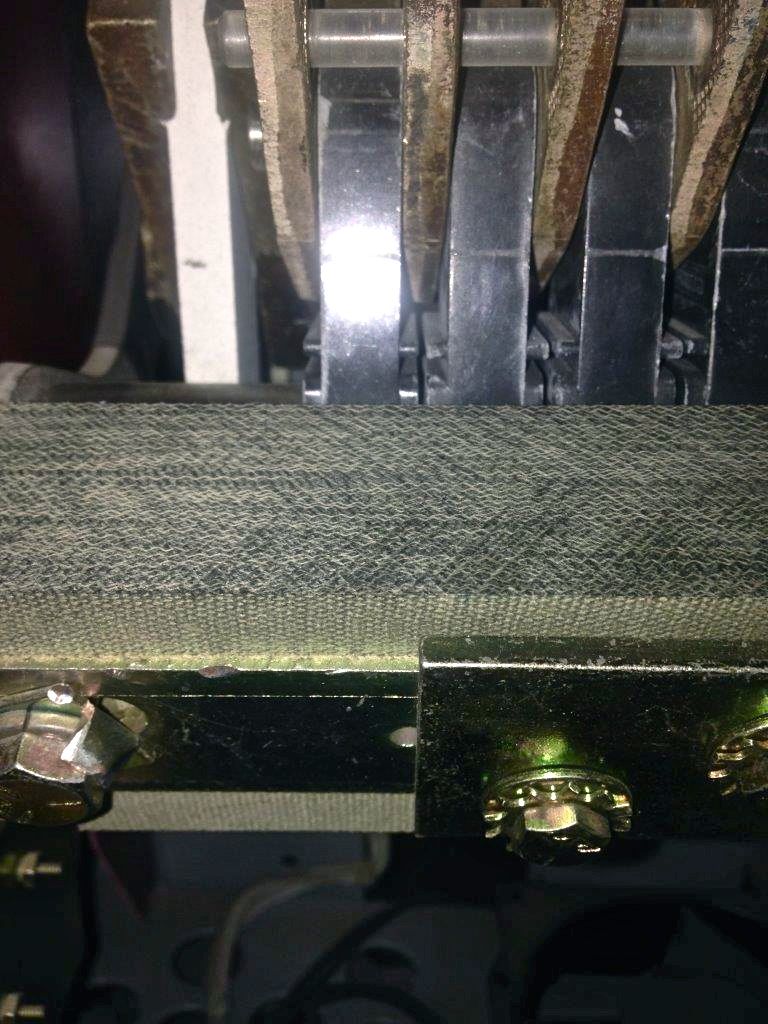

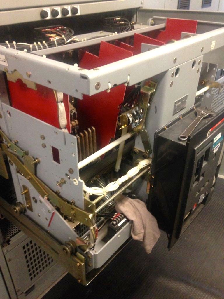

I was working today on a 5000Amp / 600Volt breaker made by General Electric. Inside the breaker I found the exact Micarta that CRK uses. Micarta was invented for the electrical industry, but I have never seen the black version in use in electrical equipment. The stuff I usually come across is an amber, brown, or reddish colour. Thought it was cool to find it there.

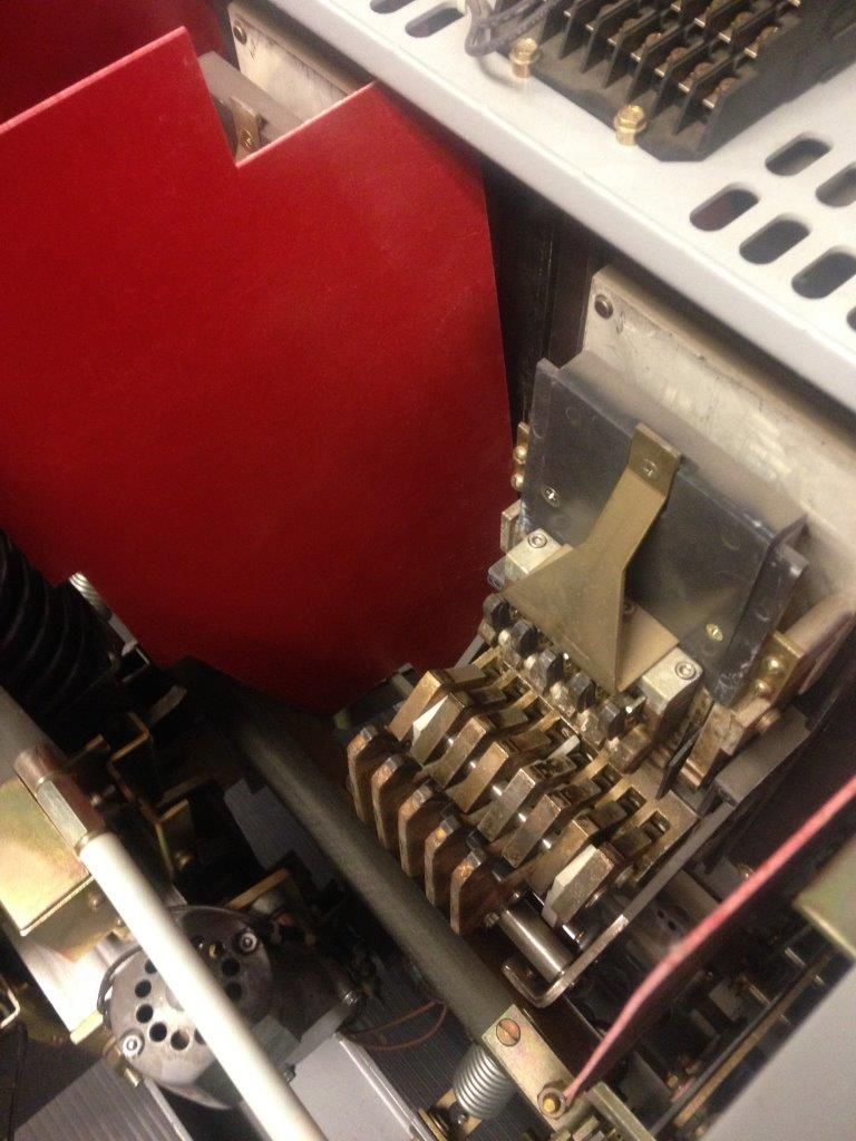

Anyways....deep in the guts of the huge breaker there is was in the form of a massive 3 foot x 1 1/2" x 3" bar of the stuff. The insulating, mechanical support that operates the three phase poles of the breaker is what was made from the black Micarta. This breaker is worth about $55,000, and this piece of material has to take the full force of the breaker opening under fault current, as well as multiple operations every day (breaker is used to synchronize generators at a power plant) so it is safe to say they are using good Micarta in there. When this breaker opens the room shakes. My conclusion: Nothing but the best for your inlayed Sebenza:

Uhhhh.....Micarta has been around since at least 1910. it was invented by George Westinghouse. There was no Radar in 1910, so Georgy was way ahead of his time I guess as far as a Radar blocker.
http://en.wikipedia.org/wiki/Micarta
With this I agree (from the wiki): "the largest use for Micarta industrial laminates is a high strength electrical insulation in power generating and distribution equipment" which is likely what George Westinghouse (of Westinghouse Electric fame) was trying to do with it at first (back at the turn of the century). There are many applications in the manufacture of motors, switches, generators, breakers etc where you have hi stresses, high temperatures, and high vibration, yet still need something non-conductive that will hold up. You need something for structure that has these properties:

Micarta was the solution. Remember there was no plastic back in 1910, only glass, ceramic, or wood as far as materials that didn't conduct electricity. Micarta was followed much later by G10, which was also developed as an electrical insulator (and is now the most common structural insulator now known as "Glastik")

Westinghouse marketed this material for many applications after its initial development as an electrical insulator. It would still be used for more things if it were not so expensive to produce. I have a really nice 5x5 foot x 3/4" sheet of amber Micarta at my shop for an electrical project that would make a gorgeous coffee table, but the sheet is around 800 dollars, so a bit too costly for that. CRK uses the exposed rough edge of the Micarta, but the face is typically smooth if not sanded or formed.
