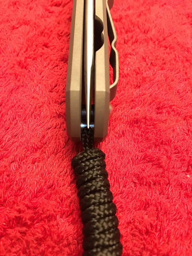

Hi blade forums. Just took the plunge and ordered my first sabenza. Anyway, I received it tonight and noticed the centering is a hair off center. I'm new to CRKs so wanted to check with the experts to see if this is within spec or should the blade be dead perfectly center??

What you are seeing could be a combination of things in respect to blade centering..
Tolerance stacking between the pivot components.
Needs to be cleaned and reassembled
Use it and cycle it for a week or two,..Take it down, clean, lube and reassemble.

I must be getting old, that's so close to center to me, I wouldn't notice it.
Some have been slightly off like yours, it's not real common nor unusual.
I'd follow bhyde's advice and see what happens in a couple of weeks, he might know a thing or two about CRK.
Appreciate the help guys and thanks for the welcome. I'll hold off on calling CRK for now and see how it looks after a week or two of use. I've already taken it down, cleaned, and lubed it so I know that's not the issue-- the centering is exactly the same before/after I took it apart
Try loosening the pivot, stop and back spacer screws a couple of turns, open the knife firmly then tighten all the screws down. This has perfectly centred my Sebbies that have favoured the lock side so might be worth a go.
Yeah, I'd say that is pretty darn perfect. If anything, it looks like the grind might be just ever slightly off center right at the tip. Wouldn't affect your function at all, but the blade itself looks very centered

My Sebenza was ever-so-slightly off-center when new, even after disassembly and cleaning. On the advice of another thread here on BF that I can't seem to find, I had success getting the blade spot-on by loosening all the screws and then retightening beginning with the pivot and working back to the end of the handle. When I cinched down the final screw, the blade eased over that last little bit to dead center and has stayed that way for many months. YMMV.

Flip the bushing and see what happens. Worst case you switch it back.
That worked for me.
I'd guess that's within acceptable limits. All of mine are off, if you have a micrometer to measure.
I'm way too picky about everything, knives included. I've been able to get all my CRKs perfectly centered, and only one of the 10 was off to begin with.
On the one, I centered it by trying different combinations of flipping the fasteners around until it was spot-on. And it has not moved again in over two years.
So try that, it might work for you like it did me.
