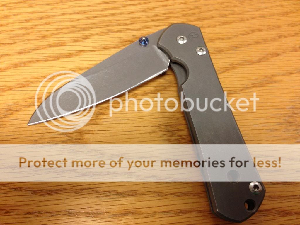

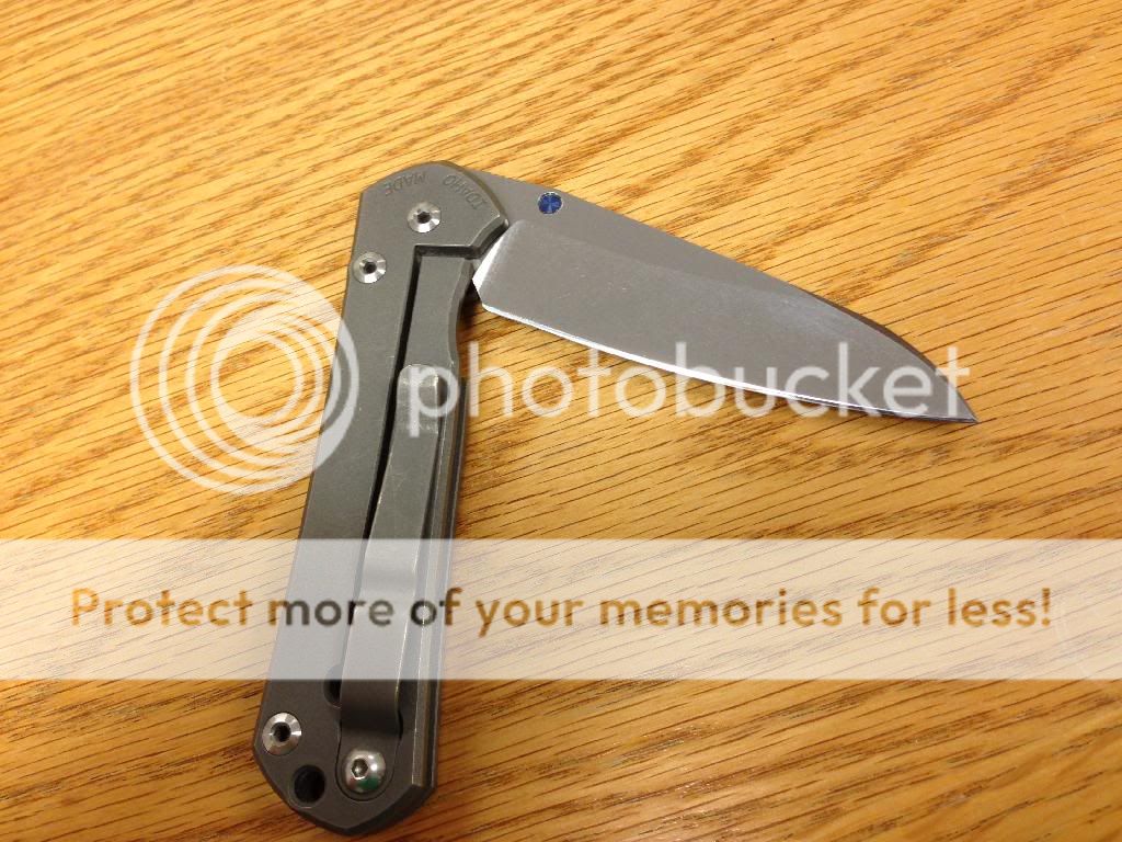

I received the Edge Pro last night and through discussions with Edge Pro, it was revealed that I do not need the riser block. After tinkering for awhile and learning the unit, I was able to learn how to use it. The thumb lug does not get in the way, nor does in prohibit sharpening the entire length of the edge. The difficult part about sharpening the Seb is the lack of flat space on the blade--holding it steady is a task.
I started by sharpening an Opinel # 6 and all went well. I moved on to a Piranha Fingerling and got a good edge, but not perfect. I couldn't hold my horses any longer and had to throw my small 21 Insingo on there and see what I could do with it. . . Pictures and details forthcoming. . .
That is pretty much the same results I have gotten on an Umnumzaan and 25. I didn't comment on your original post because I do not own a small so didn't know if the lugs would get in the way or not. Like you pointed out the hard part is keeping the flat part of the blade flat on the table. Another technique is to sharpie the edge after you got the proper angle, lay the entire blade on the table and adjust the Edge Pro angle to match the blade. I have done it that way but I feel that I get better results keeping the flat part of the blade on the table but then again this is with larger blades. Glad it is working for you, the Edge Pro is a nice system.

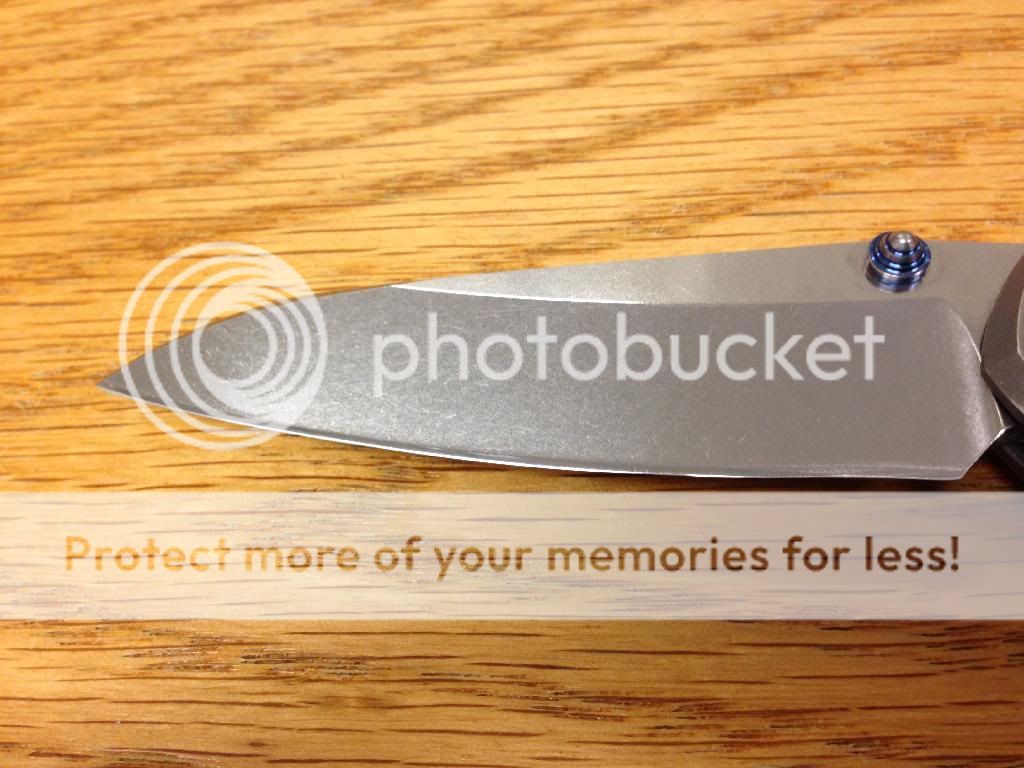

Keep in my mind, this is only the 3rd blade I have done on the EP so the results are not AMAZING.
I went through the following progression: 220 Stone to remove the slight convex, 400 Stone, 600 Stone, 1000 Stone, 2000 Polishing tape, 4000 Polishing tape.
I only had about 15-20 minutes to do it, so admittedly it was a bit of a rushed job. I know: gasp, argh, sigh--a rushed job on a Seb! Well, I was too excited to wait til I had more experience and more time.
It will shave arm hair and slice phonebook paper, but it is definitely not ready to tree-top hair or split atoms.

Nice knife MMR, and you are a fast study;), unlike myself.
I quickly went out and checked out the technique described on the VID. I still strike the T Stud, it's the low angle I use. A steeper angle will be ok. :D It doesn't matter now, because I won't need to reprofile the Seb again.
.......but the NEXT Seb :thumbup:
