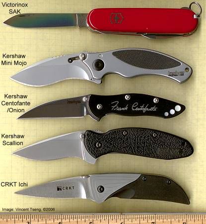

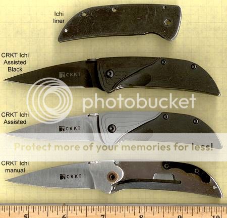

Here's an interesting small knife that caught my attention -
I guess because of its small unobstrusive and subtle size.
I actually think it's very clean and good looking.
Nice sized for use "in public" without causing a stir

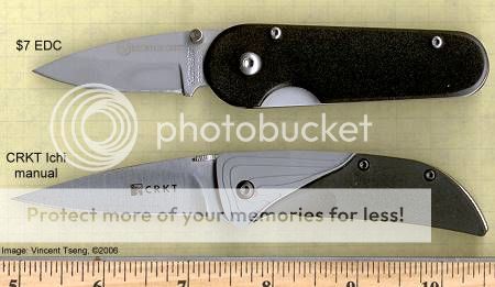

clip allows deeper pocket carry than the overly high ride of my $7 EDC....
About the same size closed - but a longer blade on the Ichi than that $7 EDC.

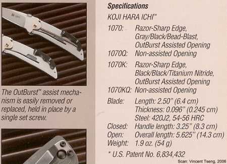

The Ichi is designed by Koji Hara and is available in both Outburst Assisted opening and manual opening.
("ichi" means #1 in Japanese).

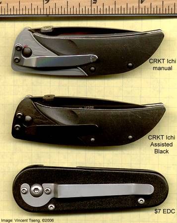

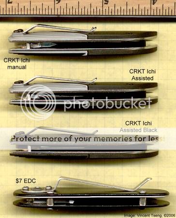

The only way one can tell if the knife has the assisted opening is either open it and feel -
or by looking at the back/spine of the knives closed -
on closer examination one can see the "extra" black spring bar on the assisted openers.
The only difference between manual and ..................................... assisted-opening -
is that extra black spring bar - one can remove the spring to make an assisted-opener into a manual, and visa-versa......

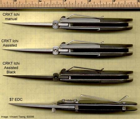

Assisted on closed and at stand-off
Where the spring is just at/pass engaging the cam to open the knife -

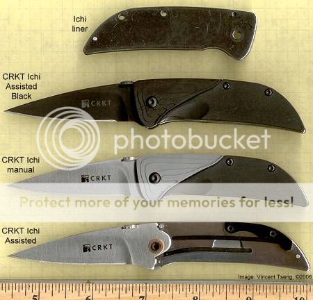

Liner-lock is pretty substantial -
and engages well - for the size of the knife the liner thickness is almost approaching a frame-lock in proportion.
Spine view -
everything is nicely proportioned - nothing seems out of proportion.....
Like I said a good looking knife.

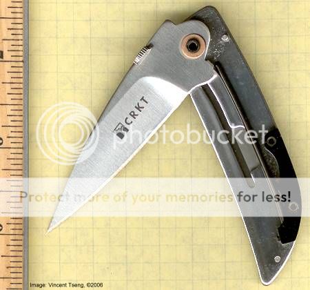

The assisted opening action is great the blade fair jumps out of the handle - but it's not too sudden to be jumpy - one can open it fast by almost flicking the disc opener and get the thumb up and out of the way. Or do it more slowly to the stand-off position where one can feel the spring take over and lift the thumb up out of the way.
The manual version feels nice and smooth with real positive click on lock-up - the thumb action is like any other regular manual one-hand opening - where one has to follow through.
The follow through is obviously not a good thing on the Outburst assisted-openers - but for some reason I do not have any inclination to do that - perhaps it's the positive way the assisted-opening takes over.
Only hint I can give is to place the thumb on/over the edge of the disc rather than trying to get the thumb behind the disc between it and the knife handle. Then push more or less in the direction of the cutout contour - works real well for both manual opening (with follow through), and assisted opening (lift thumb up out of the way).....

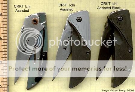

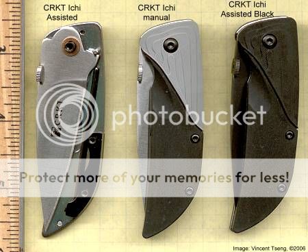

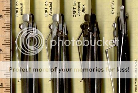

Handle scale material is Kraton - a rubbery type material with Zytel (I guess for the "bolsters") overall feel is very nice.
The black version is more subtle and probably would be "less seen" - however once seen - it conversely may attract more attention.
I really like the bright satin rubbed finish on the non-coated blade.....
then there's the "bad" news for some, the blade steel is none other than 420J2 (I may have wash after typing that... ) - not a particularly high grade steel - but probably adequate for a small light task knife.....
afterall I am carrying a $7 EDC that's most likely 420J2......
But they are sharp right out of the box - the blades have a very nice thin tapered flat ground - they not only slice free hanging paper well - but will cut through cardboard - deeper than the recent G-10 S30V Leek (matte version) I tested, and actually just better than the all steel Leeks too...
After playing with these Ichis I think I may try EDC'ing the manual version.......
