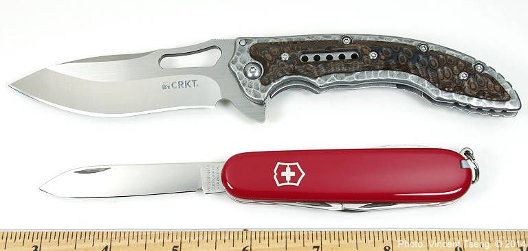

Courtesy of CRKT is this interesting folder from the co-inventor of the IKBS - Ikoma Korth (pivot) Ball-bearing System.

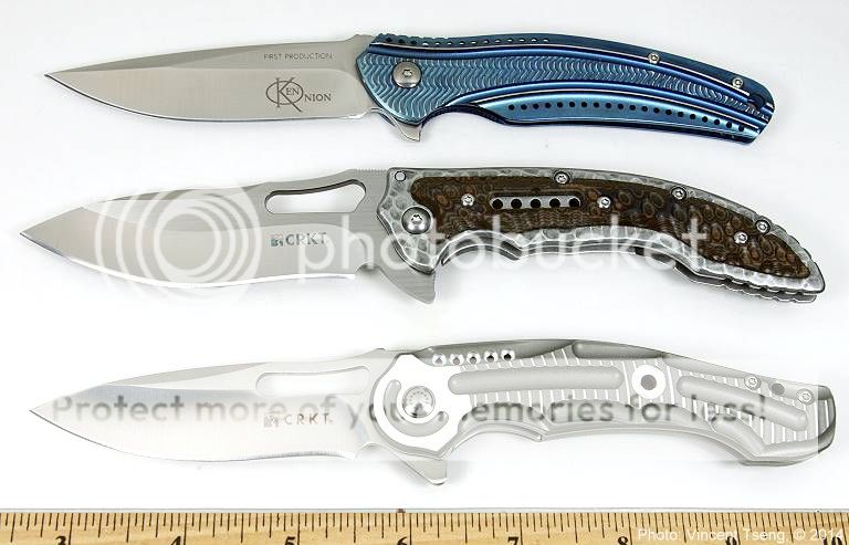

This is the small version (model 5460) which isn't all that small -

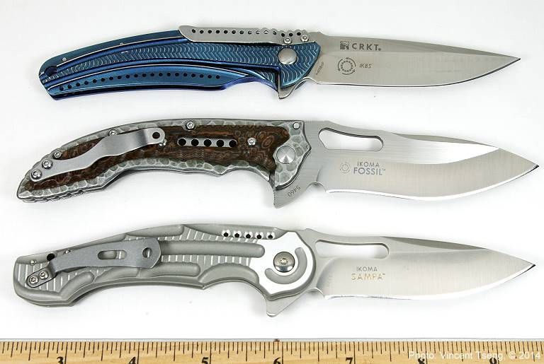

Compared to similar sized knives -
top: CRKT Ken Onion Ripple (K405BXP - original version, link to review)
mid: CRKT Ikoma Fossil Small 5460
bottom: CRKT Ikoma Sampa (5330, link to review)

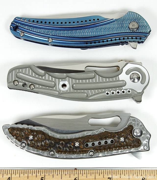

Closed -

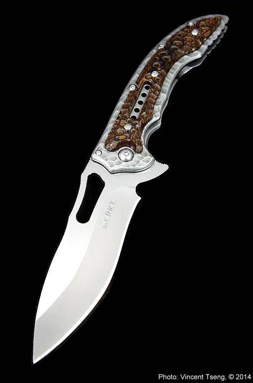

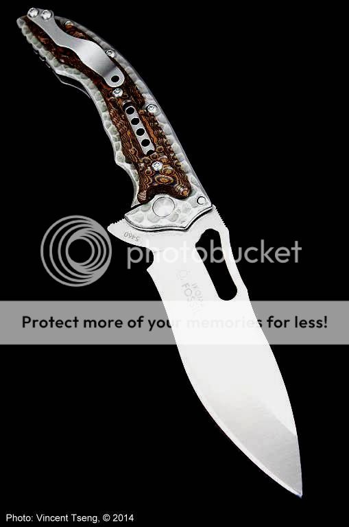

Being IKBS - it is a flipper - the action seems a bit slow'ish - that's no bad thing though -
- instead of snapping out, the blade seems to glide out - it is really smooth.

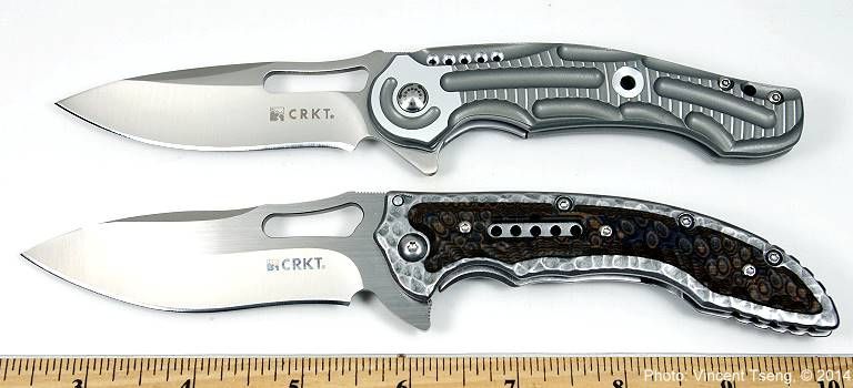

It bears very similar family resemblance to the CRKT Ikoma Sampa (5330)

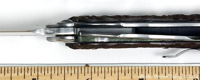

IKBS helps a great deal in keeping the blade well centered in the handle -
Notice the pocket clip on the Fossil - seems a bit over-engineered
Everything is nicely aligned -
The Fossil uses a traditional stop-pin - the Sampa has a semi-hidden one.
The Sampa is a liner lock with machined aluminum handles -
the Fossil is a frame-lock with hammered stainless steel with sculpted duo color G10 inset handles.
lock-up is good and it is very easy and smooth to unlock - and feel of closing the blade is slinky smooth - due, no doubt, to IKBS.

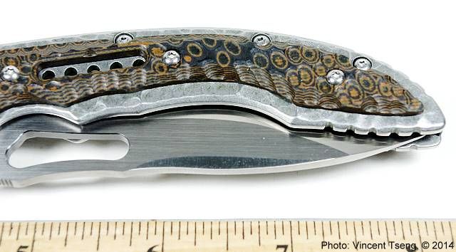

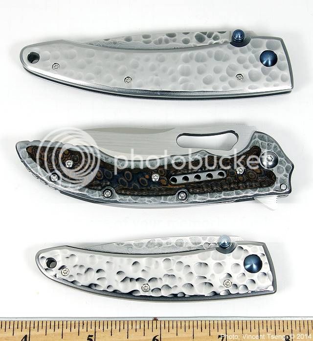

Details of hammered finish and G10 inset -
The hammered finish does not extend under the G10 inset -

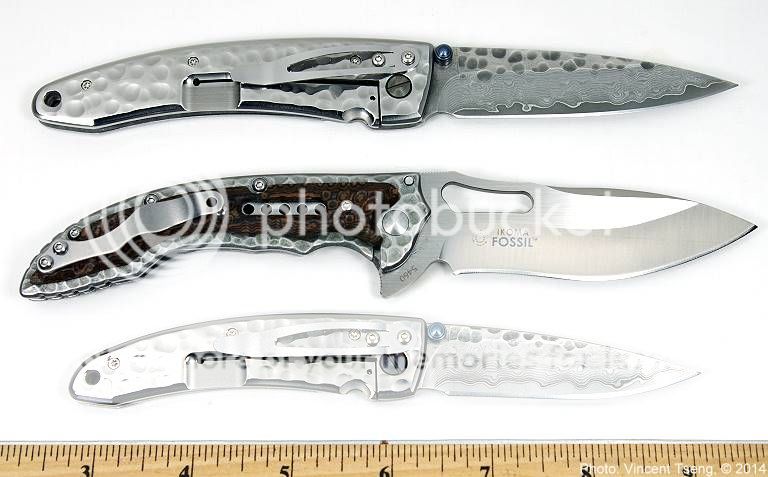

Some hammered finished knives -
top: Mcusta 114D tsuchi large
bottom: Mcusta 113D - "Tsuchi" (small - link to review)

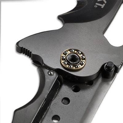

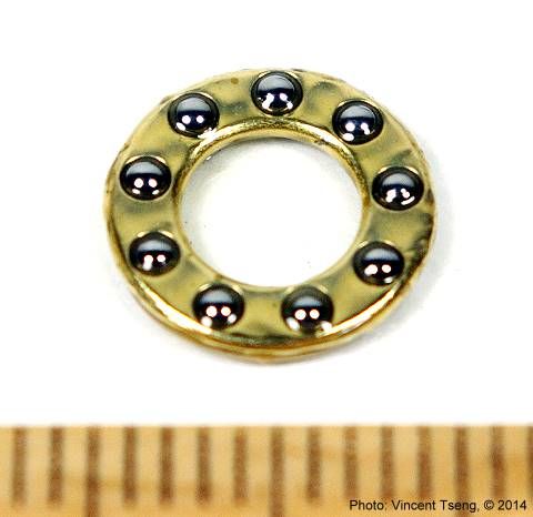

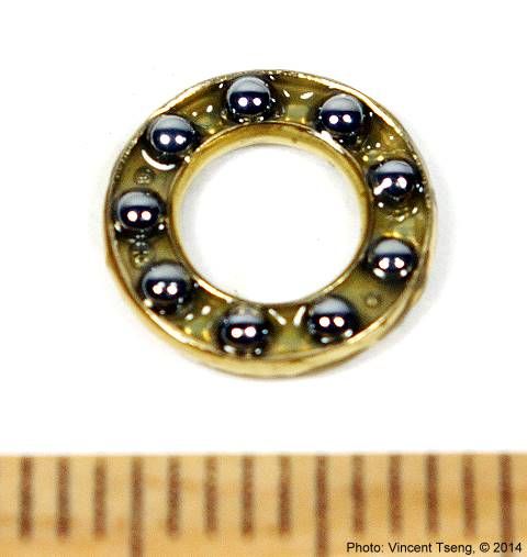

Vince, I finally checked these out at CRKT's site. They show them as having caged bearings. Can you confirm (can't quite tell from your pics). They also describe the Tighe Rod as having caged bearings, but it doesn't (at least not the one I got, which has regular loose IKBS bearings).
The CRKT Ikoma Fossil small 5460 page shows this:
(Please note: this is not my image - but CRKT - re-saved and re-hosted)

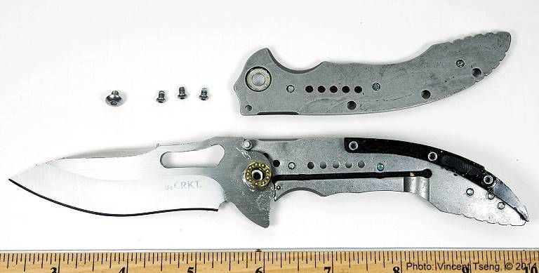

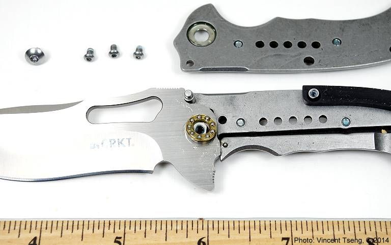

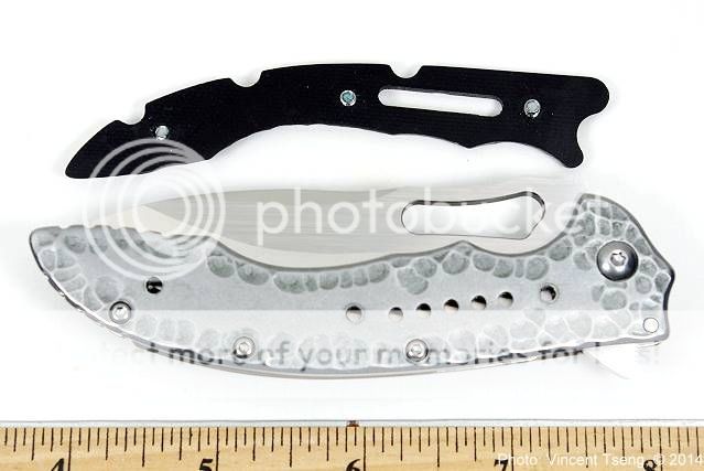

So I opened my Fossil -
Closer
Yes, that is a brass retaining cage for the IKBS ball bearings.
facing side when knife opened and the opposite side which is facing the blade -
the IKBS is swimming in light grease - I did not try to see if I could pry out a ball bearing -
but none fell out even when I took the opposite side pic which would have the open side facing down.

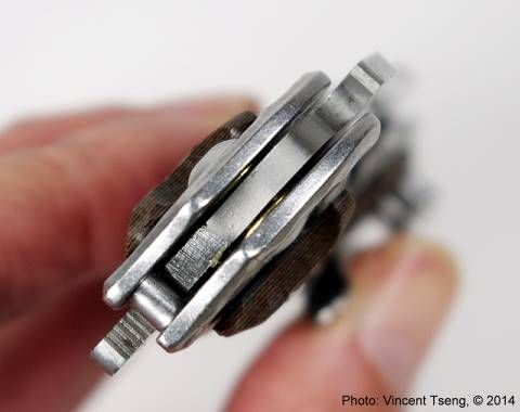

Not that it was difficult to open/disassemble -
but could save having to do any of that
simply by looking pivot end-on to the closed knife with good light -
can easily see the glint of the brass cages between the blade and scales -
