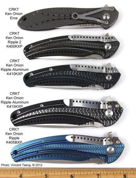

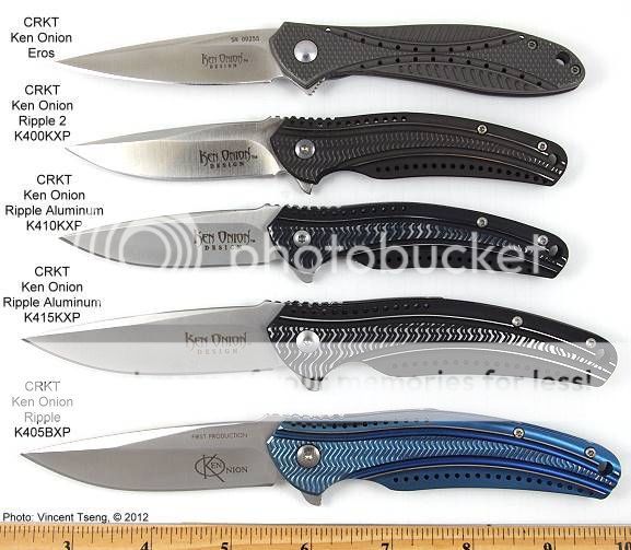

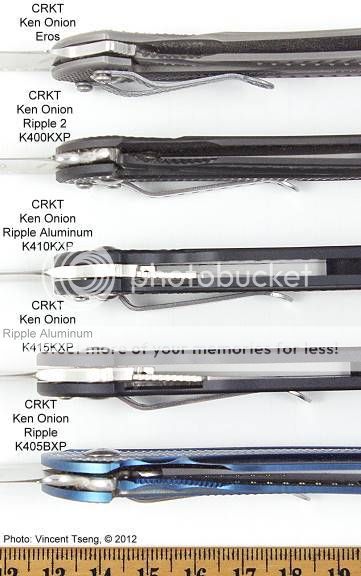

Thanks to CRKT I have these Ken Onion Ripple Aluminum
shown here with a standard 91mm Victorinox SAK (Swiss Army Knife)
As someone has said - Ken Onion design and IKBS (Ikoma Korth Ballbearing System) in an affordable knife has to be something special.
In more typical company -
Closed
The Ripple Aluminum differ from the original CRKT Ken Onion Ripple (link to review).
These (obviously) have aluminum handles/scales, and therefore are liner-locks -
instead of the steel handles and frame-locks of the original Ripples.

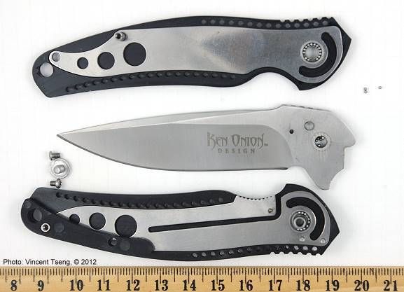

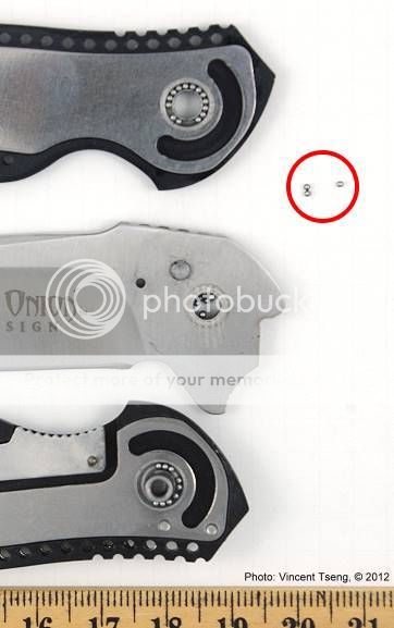

The liner-locks are well put together.
These are IKBS ball-bearing race pivots, with a very definite ball-bearing detent hole -
so the flipper action is very positive and authoritative.
However I disassembled one and I have to report it is definitely NOT something to be done in the field - unlike the CRKT Ikoma Sampa (link) that I reviewed previously -
This time the ball-bearing races are set in the liners, and there wasn't that much grease to hold them in place:
In fact some of the ball bearings fell out of place -
see highlight red circle, and inside the pivot hole.
Fortunately I was being careful and working on a contained surface,
so I think I managed to retain all of them - when I put the knife back together I would pack the ball bearings with grease to help keep them in place.
I have many knives that I have never disassembled - and they have continued to work fine for years.
I can't think of many reasons why I would want to disassemble this knife other than for this review -
so it's not really a problem -
but one should be aware of the way the ball-bearing races are used -
and be very careful during dis-assembly.
The steel is 8Cr14MoV at 58-9 HRc perhaps not quite as good as the more premium Acuto+ in the all steel Ripples - but it is quite serviceable I have read it is similar to AUS-8.

That's wise advice about inspecting the Ripple Aluminum - based on actual experience.
The IKBS are different between the Ripple Aluminum and the Sampa - and in fact the IKBS shown by the CRKT -
Ripple Aluminum IKBS:
Ikoma Sampa IKBS:
CRKT image of IKBS:
So on the Ripple Aluminum they've moved the groove for the ball-bearing races from the blade to the liners - the liner ball-bearing groove setting is actually free-moving.
There is a "warning" in the picture -
as one can see there are tiny ball-bearings loose on the paper and in the pivot hole of the blade -
they fell out of the groove as I disassembled the knife - and I was being very careful -
on the Ripple Aluminum they are not set in grease as on the Sampa.
When I re-assembled the knife I did pack the ball-bearings in high-pressure moly-lithium grease -
but those tiny ball-bearings were very fiddly to handle -
I had to use tweezers and a magnifying glass stand to do it.
Of course YMMV - you may have better eyes and more dextrous fingers.
But the point is, I suggest not casually disassembling the knife.

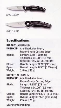

The Ripple Aluminum is listed as having IKBS both in the CRKT catalog (see scan in post #2 above) -
as well as their web page of the Ripple Aluminum K415KXP
the Ripple blade opening action is almost friction-free due to the IKBS ball-bearing system. This innovative and simple design places ball bearings built into the stainless pivot screw. It is compact and adjustable at the blade pivot screw if ever needed. Not only is opening and closing exceptionally smooth, the IKBS system is durable and requires little maintenance, and yields a folder with great rigidity and no blade play.

The IKBS is IMO a real treat on a production knife. Out of shear curiosity I had to take my Ripple apart and like others have stated it is a tedious chore. All in all it's a very nifty knife given the price and level of F&F. I hope these knives will help the general knife public take CRKT a bit more seriously.
Many thanks for your input.
Did the ball bearings managed to stay in place when you disassembled the knife?

I actually had let the pivot screw get too lose and some of my bearings had come out of place and I kinda had to do it out of necessity but still I was very curious and really eager to see the innards of it none the less. So I guess I lied it wasn't really out of just curiosity. But yeah the bearings tried to come out of place, but that was due to the lack of a steady grip I didn't have on the knife. All in all a fascinating system but very intricate.
I recently purchased one of the aluminum Ripples off the forum and I must say I'm very impressed. Fit and finish is excellent, the factory edge was scary sharp, and the smoothness of the action is just unreal. I've owned several Sebenzas over the years and this cheap $30 knife will give them a run for their money in the smoothness dept. ;)
I actually had let the pivot screw get too lose and some of my bearings had come out of place and I kinda had to do it out of necessity ....
Interesting - thank you very much for that info.
That would suggest that one even has to be careful (over) loosening the pivot screw.
Did the ball bearings in your knife have any grease on them?
Thanks,
Vincent
http://picasaweb.com/UnknownVincent?showall=true
http://UnknownVincent.Shutterfly.com
http://UnknownVT.Shutterfly.com
http://UnknownVT.multiply.com/photos
My Ripple had grease around the rings with the bearings but none in there with the bearings.
Whoa -- you're not saying the IKBS bearings fell out because the pivot screw got loose, are you?
I think even if one loosens the pivot screw enough to remove it - the two smaller screws that hold the handles together probably will keep them together enough to prevent the IKBS ball bearings from falling out - unless one deliberately pries the handles apart, or also loosen the two smaller screws as well.
