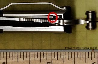

Liner-lock with Auto-LAWKS safety keeping the blade locked open -
These liner-locks are rather well done sitting nicely fully on the blade heel.
The Auto-LAWKS is a safety blocker to prevent the liner lock from disengaging -
shown below circled in red -
The Auto-LAWKS automatically applied when the knife is locked open. To close needs a little practice/getting used to.
My habit/conditioning makes me press on the liner-lock but obviously the LAWKS blocks the liner from disengaging the blade.
I had to re-train myself to pull on the LAWKS lever then press on the liner-lock - once that's done enough so that the blade is actually disengaged - one can release the LAWKS lever button which frees up the finger to nudge the blade pass the liner lock and eventually close the blade.
