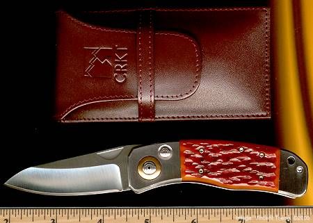

I've long been an admirer of Ron Lake's folders - to my eyes they just looked elegant - yet with the knowledge they were also very functional.
However at their usual going price I doubt if I'd ever really would have the chance to use one.
Ron Lake has had a number of design-collaborations with various knife companies including CRKT (Columbia River Knife & Tool)
P.A.L stands for Piston Activated Lock -
it is released by a button - easily done with the right thumb - it is possible with the lefthand - but obviously not as convenient. On my sample the button needs to be pushed fully in to release the lock - this is confidence inspiring as the likelihood of releasing the lock accidentally is greatly reduced. However it does make releasing with the lefthand a bit awkward (for me - since I am very right-handed).
The knife blade has what looks like large extended/expanded nail-nicks on both sides - I found I was able to easily open the knife one handed using these nicks as thumb purchase - with either hand.
I like the blend of modern locking mechanism with traditional looking materials like the jigged red bone.
The AUS-8 blade stock is pretty substantial and thick - which makes the knife look rather thick to me. Everything seems to be in proportion - so I'm not sure whether the rest of the knife was thickened to be in proportion to the thick blade stock - or the thicker blade stock was deliberately used to be in keeping with the thicker handles to accomodate the PAL locking mechanism?

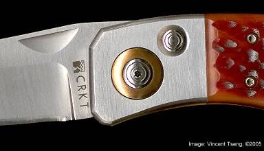

I like what looks like an attempt to reflect/match the PAL piston lock with the struts/bolts that hold the knife together - I'm not sure if they have any functional significance, other than just aesthetics - it's a nice touch.

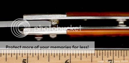

Overall quality of this knife is good the action feels real good although I could just detect some up-down (open-close direction) play in the blade when locked open - this is real small - but detectable - I think it's well within acceptablity - but I would have rather not had it at all.........
The hollow ground is not ground very thin - as evidenced by the rather wide edge bevel - but surprisingly once I got used to the knife - I seemed to be able to cut through corrogated cardboard pretty well - its preformance was actually noticably better than most hollow ground blades that usually thickens toward the edge - which causes a distinctive and abrupt step/discontinuity between the edge bevel and the hollow ground face.
Because hollow ground is thick on this knife causing the wider edge bevel - the step or discontinuity between the edge bevel and hollow ground face does not seem quite as abrupt and is further back from the actual cutting edge - so that may account for the surpringly good (to me) cutting through performance.
Looking at the etching, this knife was made in Taiwan -
I think the quality (play not withstanding) almost matches anywhere else in the world for a knife that can be had for as low as $52 street price.
Another indication of quality is the supplied leather pouch sheath, the leather looks to be top-grain - although it is somewhat let down in detail by the belt loop cut-outs which are basically just slotted holes into the pouch.........
I like this knife a lot - it is not perfect - but then what knife is?
At last I can own an affordable knife that's pretty obviously a Ron Lake (designed) knife .............
good job CRKT!

Err..sounds just like a version of the button lock? Thanks, but CRKT doesn't explain it so well
Very nice review.
I have handled this knife at a local knife shop and it is very well made with lots of attention-to-detail.
The only thing I did'nt like was the nail-nick.
And I think it would look awesome with white micarta scales!
Allen.

The button actuates/controls the rod/piston which has a very obvious difference in diameter/shoulder which fits into a graduated recess/cutout in the tang of the blade.
I think the theory is as the sufaces wear the spring in the piston takes up the slack keeping the lock tight.
As you see from my review the lock is "tight" but there is just the tiniest amount of play - doesn't really affect anything practical that I can think of - but it's just short of perfection..... but then nothing that I know of is perfect :D
The illustrations aren't all about the lock - but hopefully it's enough?
If the locking mechanism is still not clear -
please do let me know -
and I'll try and describe it better with clearer photos of my own.
