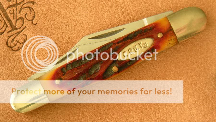

The color of the bone is typical Chinese and so is the jigging but it hasn't rubbed off on my hand or inside my pocket like a Rough Rider sometimes does. The web image lookes better than the actual knife, I think. It may improve with age. There is no daylight under the scales and even though two of the brass pins are a little proud they are not sharp.
The carbon steel blades are nice and thin and came sharp enough. I did fiddle with the main blade before use but just to feel the steel on the stone. All of the blades have a snap of about 5 - 6. The blades are seated well and the nail nicks are accessible, they look cut, not stamped. No blade wobble at all. (Main blade - 0.0225 in., small clip point blade - 0.011 in.)
I don't know how the shield is affixed but the oval shape is appealing. I don't like the registration mark in the shield though. I think the bolsters and scales are proportioned well but I hope CRKT comes out with a square end version in the future. I find the shape of the blades to be not excessively appealing but not quite 'butt ugly', still typical Chinese styling.

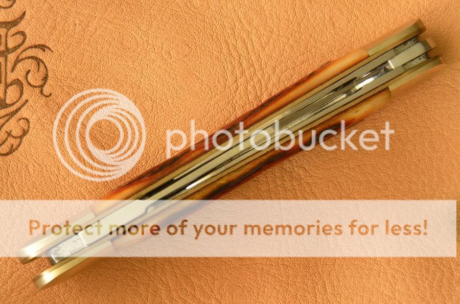

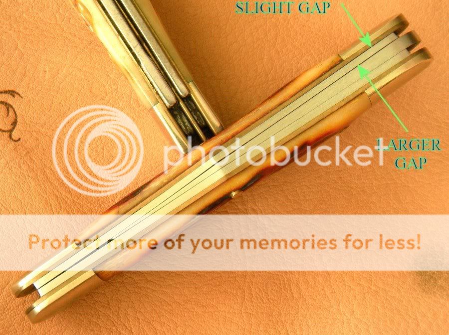

As you can see the split backspring has a few minor flaws, a slight gap between the spring and the brass liner and a larger gap between that spring and the center spring. I suppose to get any more precision in the fit would cost significantly more these days. I would rank it in the upper quartile of the usual Chinese manufacturers.
