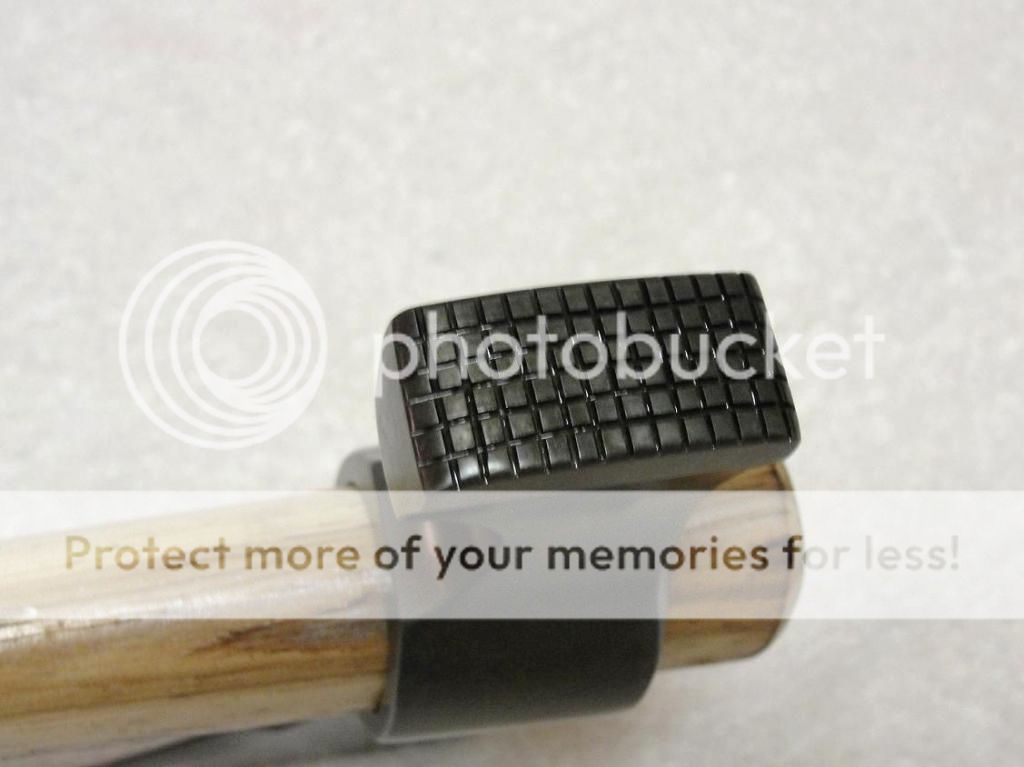

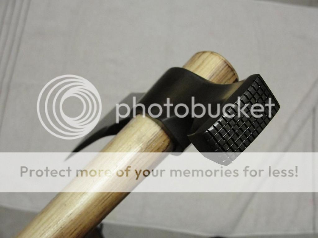

The first thing that I did was add some "teeth" the the hammer poll, as on reviewing a post on another T-Hawk having that feature it really DOES aid in keeping hand made wooden/branch tent stakes and animal trap stakes from slipping off. (especially when the wood is wet!)
I was concentrating so much over the last 3 days working on this, that all the pics are of the completed work, including a hot bath for 15 minutes in some Apple Cider Vinegar to get some protective "blue" on the carbon steel bit. (for a "primitive" blue look) I also figured that if you already own this T-Hawk, you already know what the stock version looks like. :D

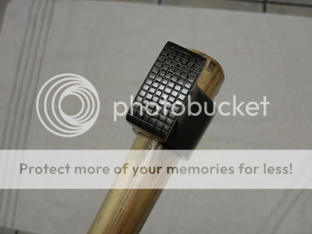

The hammer poll was "checkered" simply but effectively with just a 1" cut off disc in my hand held Foredom flexible shaft machine,....much like a Dremel but more of a pro level construction. (used one over 35 years in Jewelry repair) Efforts were made to keep the depth of cuts as even as possible for cosmetic reasons, but not functionally important of course.
Before I stripped off the paint, I used a sharp set of dividers to mark off the lines so that they would be fairly even throughout the hammer poll area. I decided for now not to bring the squares to any sort of point, as I found that they work quite well like this,....with just the approximately 90 degree cuts and sharp edges. Also, diamond points would chew up plastic or aluminum stakes much more, and this works fine as is.
I suppose the wooden stakes "compress" a bit into the 1.5mm deep channels when struck, so that there is some "bite" into the tops of the wooden stakes.
By the way, cutting the squares freehand took maybe 1 hour previously, and I used a 2.5 power magnifying headband to see the scratched in lines and protect the eyes also. You only have one shot to get the lines straight and in the right place, so take your time.
I found that grinding in a very light scratch first on ALL the lines was a bit safer, and then go back and deepen each one to the depth you want. This allows you to correct a small position error, and any missteps can later be sanded out flush at the end. The light starting grooves also tend to guide the cutoff disc, but work slow to get it right.
Overall the "look" of the hammer poll came out sweet, and as a freehand job tough to better with my 58 year old eyes and bum shoulder. (very painful calcific rotator cuff tendonitis for 4 years now! :grumpy: )
A few pics of the poll area:

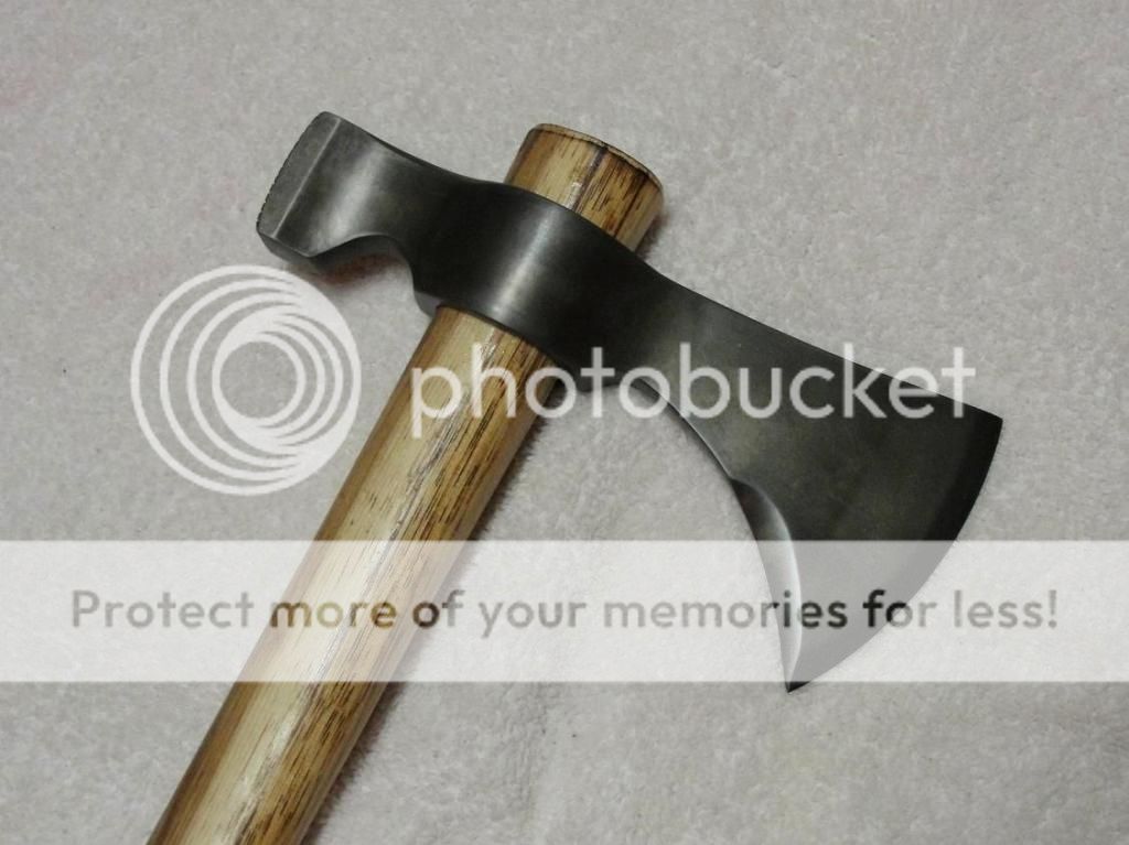

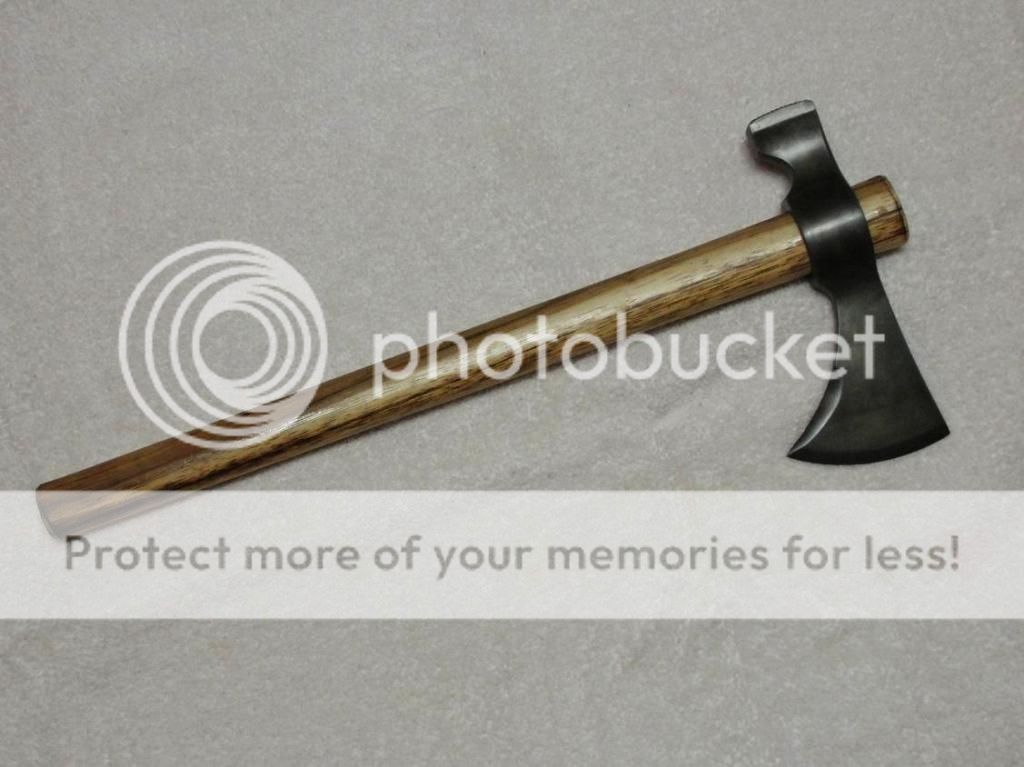

As you can see, all the original paint was removed, as well as the PITA "hammered" finish in the steel. Initially I used a 1/2" rubber drum sander to remove all the paint (fairly thin coat), as well as all the hammered finish "dimples". (relatively deep in this hardened steel) THEN the real work began, with HAND SANDING using a small wooden block and 220 grit sandpaper to get the surface as flat as possible. 600 grit followed and I stopped there as this IS a tool after all, and not a wall hanger! ;)
The hand sanding is tedious for sure, and took over 5 hours in total, split up over 2 days as it's tough on the fingers and I have a painful shoulder besides. The sanding time is of course compounded by dealing with already hardened steel. (takes lots of pressure to dig in) Next time I'll search out a small angle grinder / sander to save some effort, although you'll have to be mindful to keep the bit fairly cool. Hand sanding NOT an issue with heat on this hard stuff!

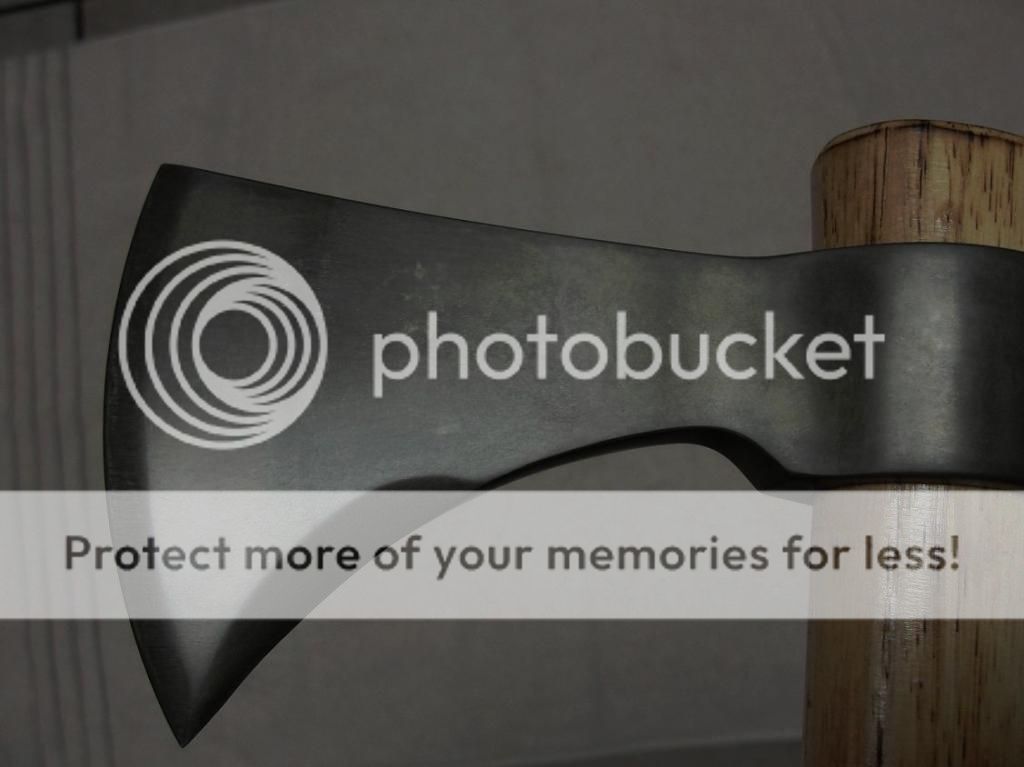

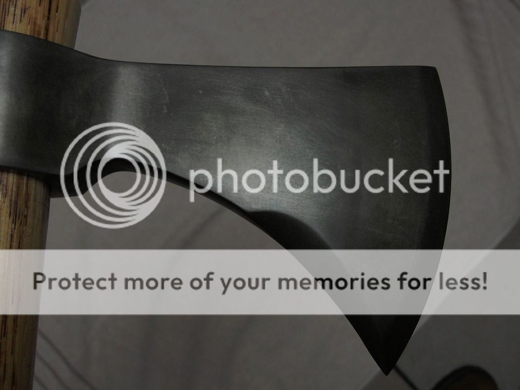

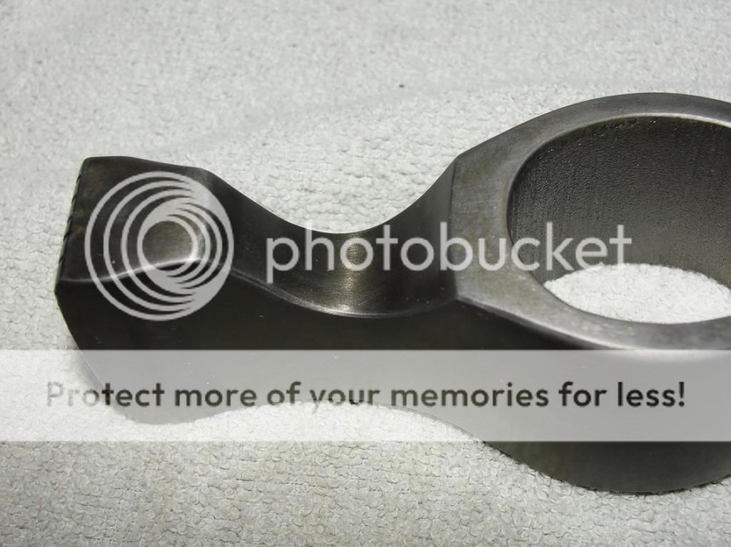

The Apple Cider Vinegar gave a decent "vintage" blue look to the T-Hawk Bit, but I noticed an interesting dividing "line" emerged where I believe the bit was differentially hardened for the blade edge, and lesser but still noticeable at the hammer poll area. Apparently the harder the steel, the more color it accepts off this primitive bluing method.
It would seem to me that this very easy and quick primitive "blue" is especially suited to a hard working tool who's head, which can be easily removed and touched up as needed thru use. :thumbup:
Less pronounced, but still a dividing line appeared at the poll end due to the bit harder steel there:

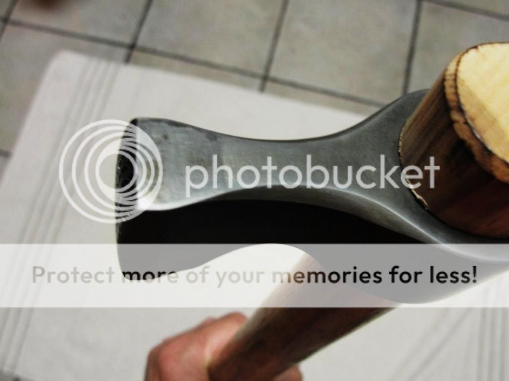

Of course I slightly beveled the previously sharp edges to the shaft opening (both top and bottom), so that the handle seats more securely and with less scuffing to the wood. ALL original bevels were also smoothed up (along the beard and also along the working blade edge), as they were too coarsely ground for my taste. They blend in much better now with the much smoother overall finish. (feels buttery S M O O T H now :thumbup: )

I had not considered a hot cider vinegar bath. Can you provide additional details on this step please?
It's pretty simply, really. After all the finish work was done, I put enough Apple Cider Vinegar in a microwave safe plastic container to cover the entire T-Hawk bit. (test the depth but then REMOVE THE STEEL BIT!)
I microwaved the approximately 1 quart of apple cider vinegar for 3 minutes, or until the vinegar was uncomfortably hot but not scalding to my bare hands. (had I had insulated gloves available I might have gone hotter! :-)
While the microwave was heating the solution I really scrubbed down the bit with a scotch guarded sponge and hot soapy water using dish detergent, and rinsed really well. I tried to keep my fingers OFF the steel once it was well rinsed, and handled the bit from the "eye" opening only. The final rinse water was HOT, to pre-warm the steel to keep the temperature as high as possible during the 15 to 20 minute soaking time. I also flipped over the bit a few times and regularly agitated the solution every minute or so for a few seconds by gently shaking the container from side to side.
For the record, the apple cider vinegar also works COLD, but I found it takes a lot longer to color up. Once I was satisfied with the color, I removed the bit and rinsed it really well in warm water, and used the soft side of the sponge also. I towel dried the bit, and used rubbing alcohol at the cut out poll hammer end to get rid of all the water there in the crevasses.
.....and a final wiping with mineral oil to set the "blue" and a few minutes later wiped off most of the oil.
I've used this "Blue" on a lot of my 1055 carbon steel knives, and like it for the ease of application, containing no harmful chemicals, and also the ease to touch it up when needed. Pretty cheep too, as a whole gallon of the house brand (Price Chopper) was just $3.00 at my local supermarket. I have found I can even re-ruse the solution at least once more, and I store the "used" vinegar in some old plastic iced tea containers with the screw on tops,...AND MARK THEM! :D
As a side note, this Apple Cider Vinegar was listed as being a 5% solution strength, and it didn't smell as strong as another older bottle I had when I did some knives last month. I had already thrown away the container, but suspect the solution strength was higher as the smell really was more noticeable than the new stuff. Perhaps Aplle Cider Vinegar gets stronger with age, as the old bottle was at least 5 or 6 YEARS OLD! :rolleyes:
If you can find some in a stronger than 5% solution, I would go with that as I found the other stuff worked quicker.
As a side note, I will say the hand smooth-sanded sides and slightly beveled edges make this T-Hawk bit look like a million bucks of top notch quality! All the hours of sanding well worth it. It even looked pretty sharp left in the "raw" steel, but decided I wanted at least a light coat of protection.
I meant to ask earlier if others have noticed their CRKT 2730 Woods Chogan T-Hawk has what looks VERY close to a Convex Grind (sort of semi-convex?), although in the advertizing it's described as having a "Flat Grind"?
......anyone else notice this on their sample?

Yesterday a couple of 3-4" diameter dead trees fell to her edge, .....some more victims of the dreaded "Kudzu" vines. Other than a bit of the vinegar-blue lightening on just the first 1/4 inch of the blade, which I expected, the finish still looks great.
But it's nice to know at any time that could be quickly touched up.
.......for now I like the slightly used "look". :thumbup:
