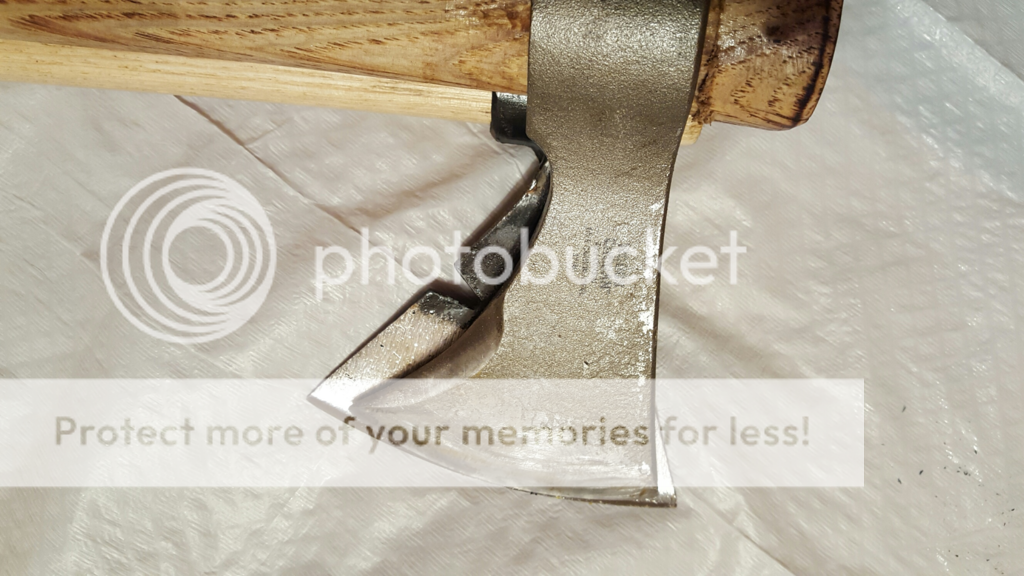

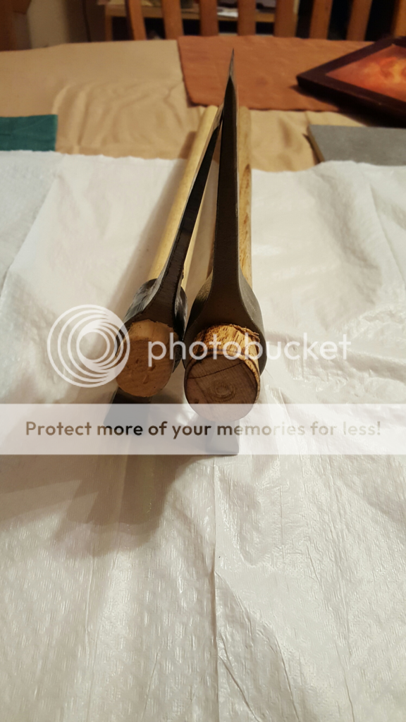

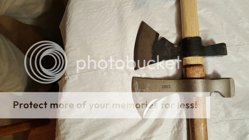

I got the Rinaldi in today and took it and the woods chogan out for a few minutes. The Rinaldi is lighter and thinner and the handle is a bit shorter and smaller around. I think which one a person prefers is going to be purely a matter of personal preference. I took a couple of (fairly mediocre) pictures, but hopefully they are good enough to give you an idea of how they compare.
Thx Soooo...much PD, for the follow-up. Pics are just fine. Tells me just what I wanted to know. Appreciate it. ;')
