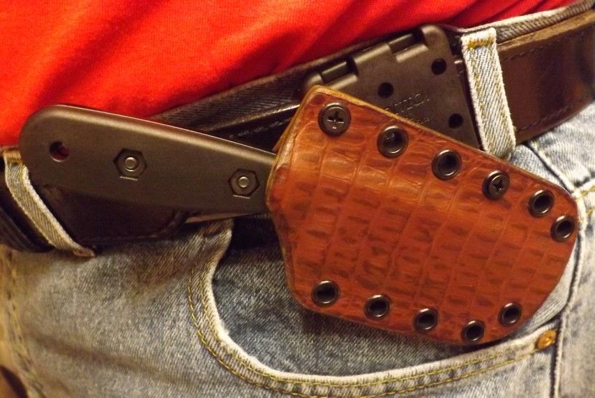

Does anyone have a kydex cross draw set-up kydex sheath for a 10 ?
Im trying to get some idea of how to do(make) a cross draw 'screw on' accessory for like a Azwelke kydex taco
Since a horizontal BK10 would be handle heavy, Im thinking a extension to get to a balance point

I don't have a 10 anymore, but do have a sheath that I got from JD at The 710 Custom Sheaths that I use exclusively in cross-draw fashion, at least when I wear it on my belt. A lot of the time this sheath is piggybacked on one of my chopper sheaths, but I do carry it some by itself too. Just need a sheath with holes set up to accept a Tek-Lok, and you're off to the races. This one happens to be just a little BK14, but you can do it with a Tek-Lok and any sheath as long as the holes are spaced properly:
