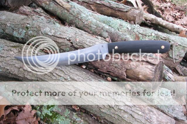

And the new knife, a JK Cutlass (I believe that's going to be the official name)
I received this as part of a pass around, I was the 4th person to try it. Protourist here on BF came up with the design- to quote him "Yesterday John and I discussed a heavy duty skinner that I'd like. It will be roughly 13 1/2 inches overall with a roughly 8 1/4 inch blade of 3/16 O-1. The design is sort of a cross between a Randall 3 and a Randall 4 and it will have Ebony scales"

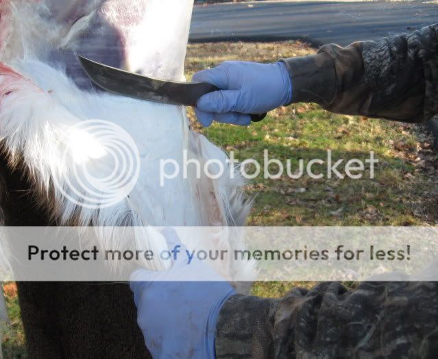

I believe he intended it as a skinner for elk and moose mainly, so I thought I'd try it on a deer. Gotta say from looking at it, it's not like any knife I have and I probably wouldn't have picked it to use. With that said it worked great on that doe, really couldn't ask for any better. In use it doesn't feel overly large and it has great balance. The blade shape and point worked really well.
Field dressing was a breeze, and it split thru the breast bone with two swings.
Skinning and cutting up the meat

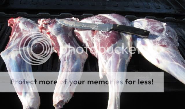

part of the end result
I'm gonna say that if you like the Randal model 3 and 4 and want something similar you need to check this one out.

I'm interested to hear what you thought about the handle angle. Did it put your hand in a natural cutting position? Was it comfortable?
John will be making me a 5 inch version of this in 1/16 O-1. What would you change in the design?
I liked the ergonomics, it is comfortable to use.

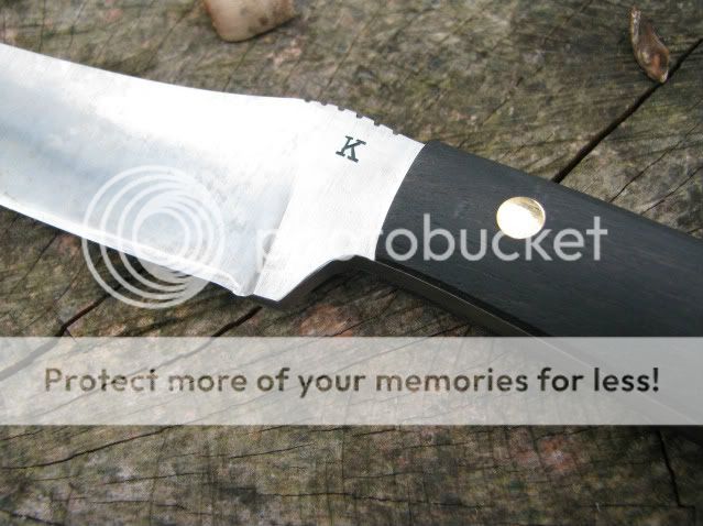

I believe 1066vik sanded the sharp edges at the front of the grip. Which works, but I would make the handle slabs come up closer to the blade. That is a preference of mine.
A 5" version in 1/16" sounds awesome. I'm really liking thinner blades right now, my last couple have been 3/32".
Good to know, thank you.

That big trail point looks like it would cut like crazy!
Bruce
Bruce, I have to admit that I never liked trailing points until recently. After trying one and seeing just how well they cut I am hooked. There is something about them that I should have recognized years ago.
On future versions the handle will be a bit shorter, so the slabs will come further up. The wood was only available in 5" long pieces, not long enough for the handle.
I should have thought of that when drawing it up. It's good to know now, mine is exactly as I had envisioned it so I sure won't complain. That's why I wanted other people's opinions. You can't really be sure about a design until it's been used.
I did consider that the handle could be shorter for my med/large hands and not give up any comfort, but some guys with xl hands might like the extra room. As it is now it looks very proportional, and that might change with a shorter handle.
I like the ebony handles, but did notice that they shrunk a little. As you can see in the photo, you can just catch your nail on the tang, but you don't notice it during use.
A thought about the handle. What about keeping the overall length and moving the scales forward, leaving an extended tang with a lanyard hole? What do you think?
More like this.
I know that I like them but some don't. I guess it's an option for those of us that do.
