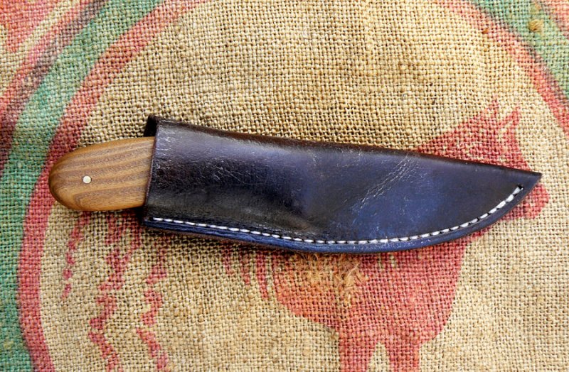

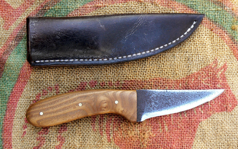

Here's a knife I made from a Crosscut saw blade. I love the metal in these type saws.I usually heat treat these but, Did not HT this one,I have been experimenting lately with different saw blades. Had to use a torch to get the handle red hot,where the pins were going, so I could drill some holes for my pins, I kept the blade in water so as not to mess up the temper in the blade. These handles are "Russian Olive" very light wood but, pretty strong. I made the sheath als

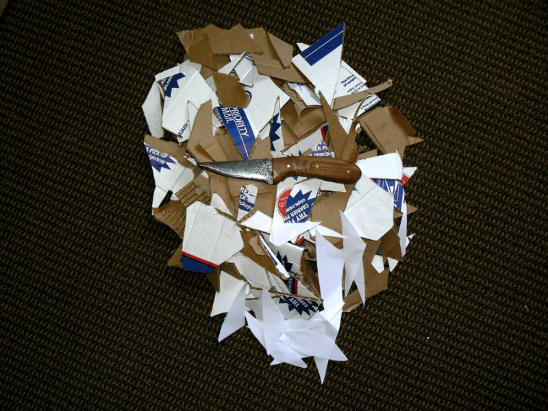

ne of my test I did with this knife, was to cut 122 pieces
of thick cardboard and it still would shave hair off my arm and slice paper easily.
Thanks for Looking
Frank
Overall length.....8 1/2"
Handle length......4 1/2"
Blade Length.....4"
Steel.....Crosscut saw (Not HT)
Scales.....Russian Olive
Pins.....1/8" brass
