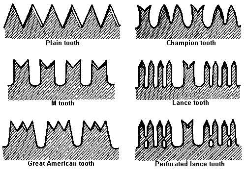

When you say 'regular tooth' pattern do you mean plain tooth?
Thanks for the reply! The starter teeth are plain and the main teeth are the great American pattern.
