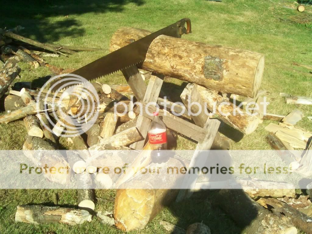

Some pics to get things rolling
Pile of white pine cut with a CC and double bit axe
Plaintooth CC working on a pine (fuel also pictured... Not a coke person by the way. just had that on hand)
