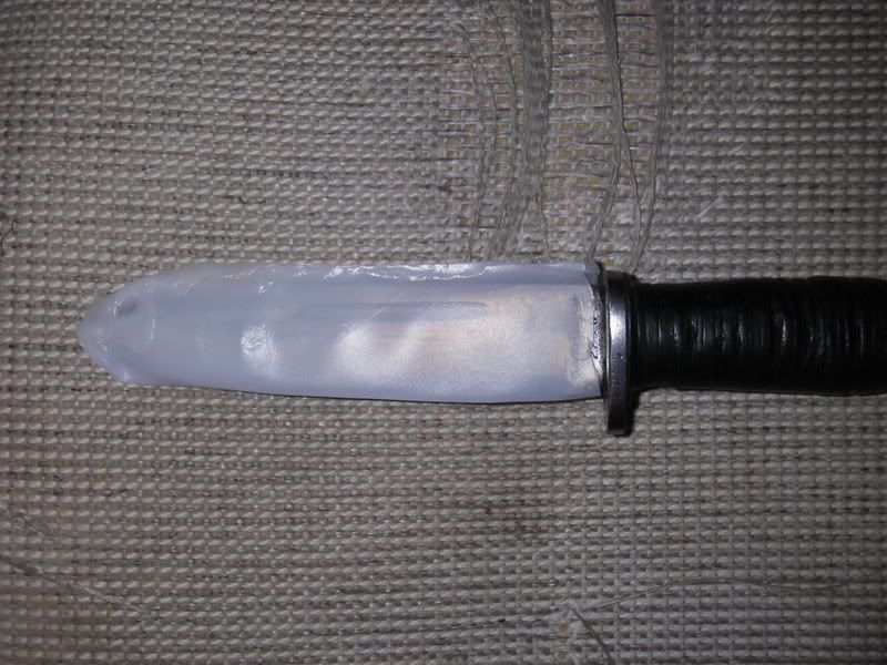

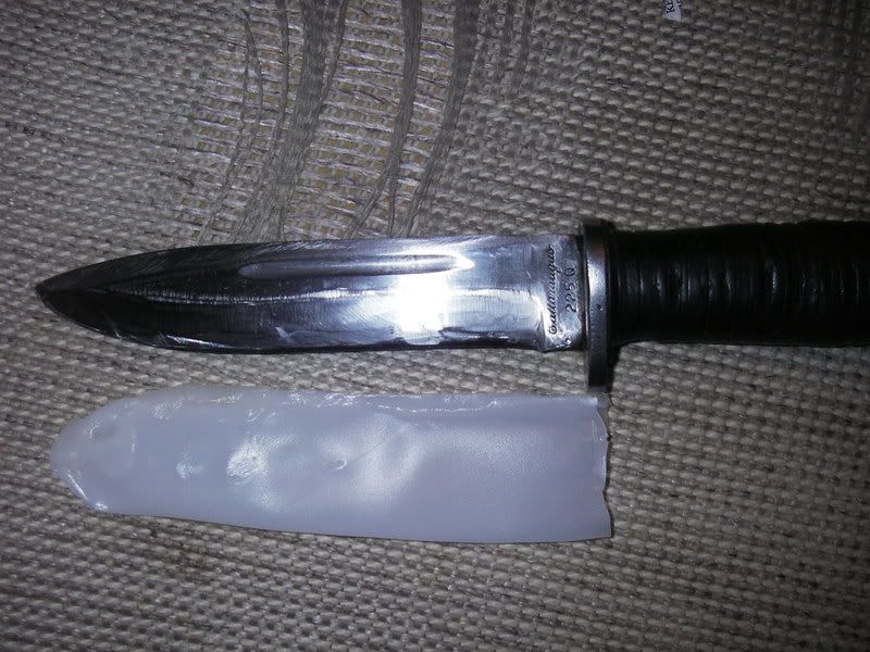

For a liner, a plastic milk bottle cut to fit and heated with a paint remover. The frosted plastic turns clear at the right temperature. Stop the heat and press it into shape. The plastic is hot, so you may want to wear gloves. (I often weld for fun and don't mind a little fingertip heat.)
trim off what you won't need. Note that I left a little extra plastic in one or two places, more on that later.
