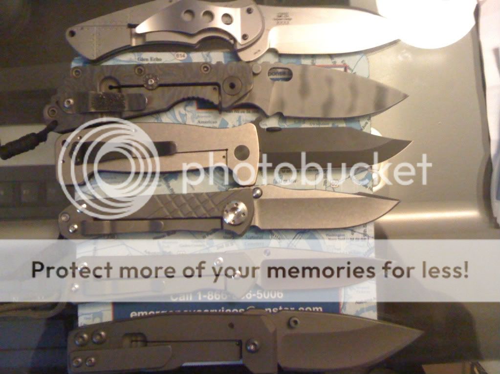

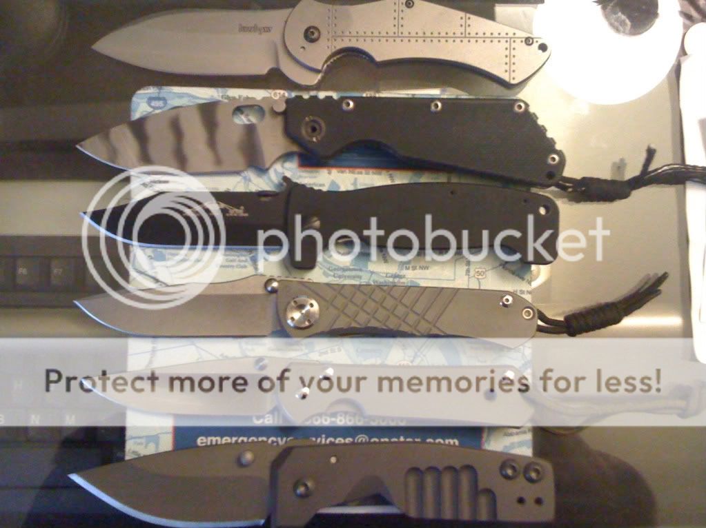

I have a Crusader Forge VIS 01 T. Bought it new from Crusader Forge/Trident for $495.00 a couple of years ago. http://www.crusaderforge.com/TACTICALCUSTOMFOLDERSCF.htm
Here it is compared to other Crusader Forge knives an RS01 and Trident Oberland 01
Here it is compared to several other heavey duty folders
They are built to stand up to almost anything you would put it through. It's not as big as many think. It is a pocket full for sure but rides in the pocket fine. It's sturdier I think than the Strider AR/GB. The lock will not fail unless you put it in a vice and try to break it. I love mine and would never sell it.

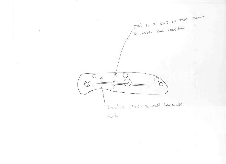

I probably didn't explain it well, but it looks like you're talking about the "over travel" feature of the LBS, which isn't it's primary function. The primary function of the LBS doesn't seem to have anything to do with how the relief area is cut. Here's Rick's explanation of the LBS:
Hello Everyone!
I felt that I should write a post explaining the new feature on Striders framelocks, the Lockbar Stabilizer.......Of course as all of you have found out it is obviously a overtravel stop..in other words it prevents the accidental overtravel of the lockbar during closing of the knife...some of you have stated that sometimes repeated closings sometimes weakens the lockbar and thus the lockup is not as tight,well, I can visualise that,but actually the problem I wanted to correct concerning overtravel is the complete overspringing of the lockbar thereby rendering the knife useless...cant be done some say?...a little story of how I came up with it...I am firefighter as alot of you know...while working a accident scene I was using one of my Firetac's to cut the upholstry material around a seat post prior to using the jaws to cut the post...being that it was a good wreck, and adrenalin was running high,and the fact that we wear heavy gloove when working a MVA,I pushed the lockbar way to hard thereby springing it,and of course the blade could no longer lock,not a good thing to happen, at the wrong time! I knew then I needed to do something about it...The other issue I wanted to address was the lockbar springing towards the back of the knife when gripping it...this is what is not so obvious in a improvement...the reason is that sometimes the movement in the lockbar is not really noticable when using the knife under normal conditions...but when you use the knife really hard, and really grip it you WILL move the lockbar..this is because to make a framelock or linerlock for that matter you have to cut the long slot in the frame or liner to make the lockbar,it does not matter what size slot you cut you will still have material missing there...simple physics, suggests that you have a lever and it will move toward the back of the knife...guaranteed...now, what does this mean...1, whenever you have movement in a mechanism it is a chance for that mechanism to fail..2,extra movement in the lock to blade joint will wear the lockface quicker...3,when the blade is locked up on a framelock with the lockbar stabilizer there will be absolutly no movement in the lock....
So given all this is the improvement overkill? Extreme?.....when do we stop designing extreme use knives,as in ... is good enough the way it is?
Myself and Strider Knives design hard use knives gleaned from actual field experience,I didnt hear of this problem from anyone else in the field,I was in the field and experienced it!...Given the addition of the Lockbar Stabilizer Strider framelocks are even tougher and more hardcore than before..worth it? YOU BET!!
