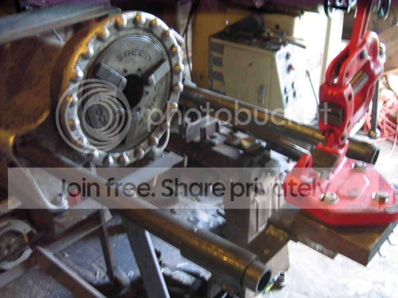

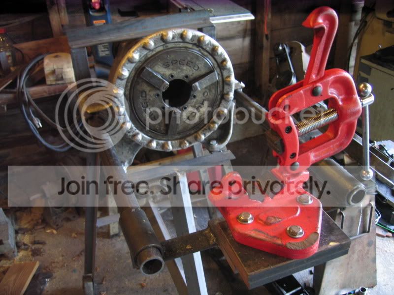

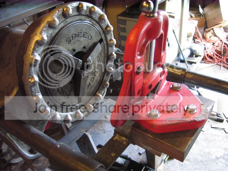

Yup twisting up to 1" is not too difficult with a good pipe wrench with handle. I made up a twisting jig that makes 1" twist really easy. Used a design I got from JD Smith.
It took 500lbs of force (Mike and I) to twist a 2" billet. If you are interested I can take a few shots of the jig. Takes some lathe work but it is pretty simple.
Joe,
Yea its a ridgid 300 that I converted. It used to take me a day of hard work to twist up 5 billets but with this puppy I do it in an hour without breaking a sweat.
I wouldn't suggest it for the average knife maker but if you need big billets or a lot of damascus it is a wonderful tool.

I'd like to see more pics
I can picture that the bearing may be just a grooved sleeve with set screws inthe groove,
but how is the billet secured into both the live and dead ends ?
What did you have to do to convert it?
I checked the specs as 1/2 hp and 38 rpm
Is it still that way and is there anything else you would have done to it knowing what you know now?

Converting was pretty simple. I replaced the arms and added a sliding bar to the arms. On the sliding bar I have a pipe vice that is adjusted by adding or removing plates under it and then bolting it down. This keeps the bar stock centered while twisting regardless of the diameter. I still have it set up at 1/2hp and 38rpm.
To be honest unless you set it up correctly it will be an expensive hassle. I have mine set up so I can get the bar from the forge and twisting faster than just the time it used to take me to get the bar from the forge and clamped in my post vice. The key to this was the special pipe vice, its hinged on one side which makes getting the bar in place as easy a pie.
Honestly there isn't anything I would do differently. The machine has its limits and once I hit them I will build a bigger twister for really big bars of damascus. I don't know what the maximum size it will twist is but it twists 1.25" without issue.
I'm not real good at describing what I did to convert it so I'll just post some pictures tomorrow.
