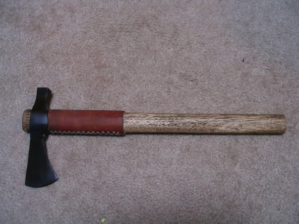

you guys gave me some incentive to try and mod a CS hawk. so $24 later this is what i came up with. i recontoured the bottom part of the hawk and did some file work near the eye. i also had to heat it up and pound out the scoop the blade had in it. the thing was pretty crooked to start out with. then i took out the marks left by the grinder they use. and did a mix of browning and blueing to make it look a little more antique. stained the hickory handle after a slight bob of the end. finished it off with a leather sleeve like i see on all those really nice hawks. it looks pretty close to what i would want from a custom hawk but now i can bang this one around and not be worried. thanks for trying it first guys. i never would have thought of it.

Nice work man! And some say CS hawks are POS's! I like the step down on the blade you did from straightening it. Great leather work too.
I still think they are good basic raw material to build your own customization. Also nice to hear it put the bug in you to try it, that's where the fun and satisfaction come in.

Ok, you've got me ready to order a trail hawk to play with. What did you use to work the inside of the eye? I was thinking a Dremel, but maybe a round file would be better.

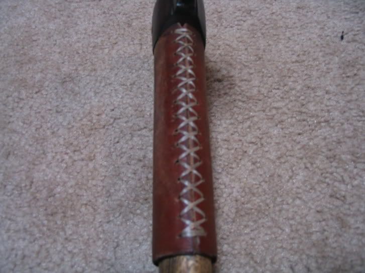

i took the hard route and used a big flat nicholson for the area nearest the center of the hawk(whre the handle goes through). then a combination of half-round and dremel tool. if i had a grinder it would have been done in a matter of minutes. just draw a line with a magic marker and get to it. i used a $40 belt/disc sander to true up the flats. i used the dremel with the cut off wheel to start and then follwed up with a file to make the decorative cuts. i'm thinking of doing a CS Riflemans Hawk next but recontouring the hammer poll to a more pipe style. the leather coller thing was a lucky first try. i cut the leather to fit perfect and then drilled the holes for the lacing. then i soaked the leather in hot water and strethed it out as much as i could. then i laced up the leather(off of the handle). soaked the leather another time for good measure and blotted it with some paper towels. then i fit the sleeve over the handle. it made it most of the way down but i had to pound it down for about the last 4 inches with a piece of wood. i smoothed out the leather that took the wood beating and now it's dry and tighter than a frogs a$$. i like th burned handle look so i might try that as well as some brass tacks maybe. i will say that this took me a long time. much longer than i planned. i can just imagine how long it must take to forge a hawk from scratch. my hats off to all the skilled hawk makers out there.

You mean the Taiwan stamp? Just sand it or use a Dremel and it removes easily. I then put cold bluing over it to match the metal color since I remove all the paint anyway.

I was refering to the pics of the hawk that Blaster4 has posted at the top of this thread..It is obvious that the leather is laced like a boot, but I thought that someone said that the end of the lace was terminated with a cris reeves knot?? I can't see it!! I must be mistaken:D thanks anyway..
to tell you the truth i had no idea what kind of lacing i was doing when i made that. i just tried to copy what i saw on others. as for the knot...well i'm not sure what you would call it. maybe the "a lot knot"...when in doubt...
i'm sure it won't come undone and i did tuck it under the leather when i was done. here is a couple of more pics. sorry i couldn't really help you out with the knot.
