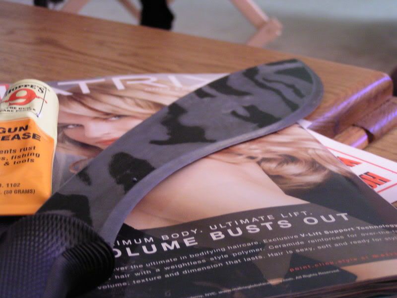

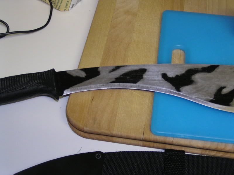

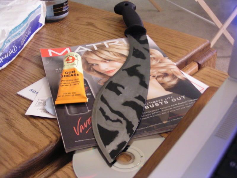

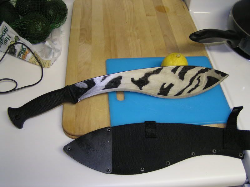

razor is not good. I have 3 blade from the coldsteel machete line. They come from the factory with very bad quality control. First the black paint strips of when you try to remove the sticker with either alcohol, or nail polish remover. First thing i did was remove the finish. Then the grind, the grind is onevenly done with flat edges, wire edges and different angles.
What you need to do is like Cliff said is remove the stock edge, it's worthless. Then make a new edge but at about 40 degrees. This is a good compromise between a sharp edge and a durable edge. I sharpen it till it cuts paper, not till it's shaving sharp. If you put on a very fine edge it will roll.
When you finished your machete, after paint removal, satin sanded the blade and applying a good edge the machete is quit good. I have used my kukri machete to remove treestumps, chopping into the earth and thru roots. It did some minor damage to the edge but the kukri withstood full power blows. The steel is designed to withstand abuse and seems flexible enough to withstand bad cuts, but you have to give some edge retention away.
After "pimping" your kukri you have a good user. The sheath sucks imho, it's more geared toward storing the blade then actually using it on your belt on a camping trip.
