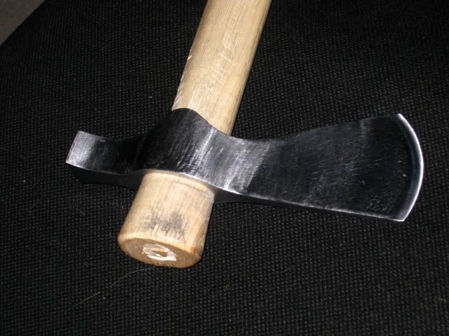

Just bought a CS TrailHawk and after I stripped the black paint off it, got rid of the set screw and polished the head, I got it just where I want it!
Sharpened it on a fine diamond stone and now I can slice newspaper
with ease. I'm going to do some chopping with it over the weekend and
maybe even some battoning. If you take the head off the handle and
batton the hammer poll, you can use it to split rounds of wood.
Looking forward to doing some playing this weekend!
