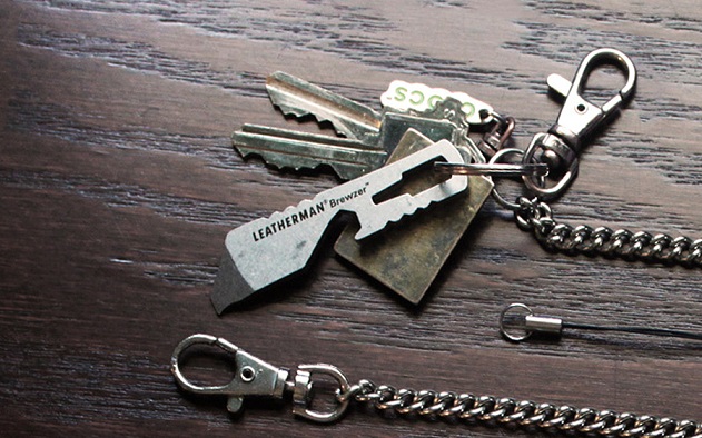

You should get one of these. They are cheap
Leatherman brewzer
Not my pics
