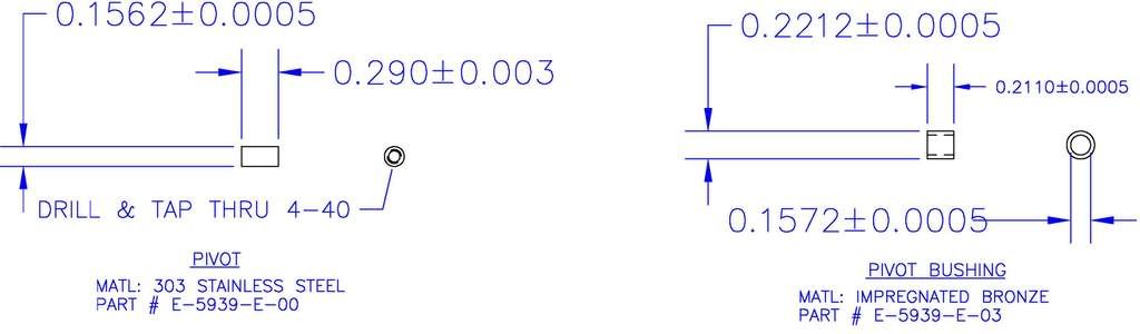

Here is the drawings for the pivot & bushing.
I assume your bushing is still there though.
The screws are just short 4-40 flatheads.
I hope this helps.
Thanks for the drawings Phil.
Unless someone knows where to purchase these tiny parts, I think it's time to give the knife (and drawing) back to my buddy. Maybe he can find a machine shop willing to make him what he needs.

A million thanks go out to Phil Gibbs for locating the pivot parts I needed to restore my buddies knife! :thumbup:
Phil, the parts fit PERFECTLY and the knife now functions like it did the day it came out of Camillus! My bud and I both thank you!
