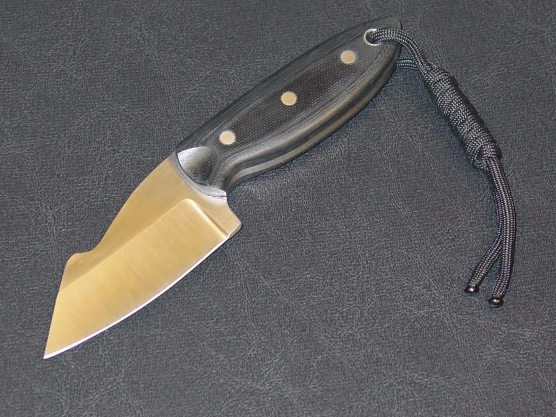

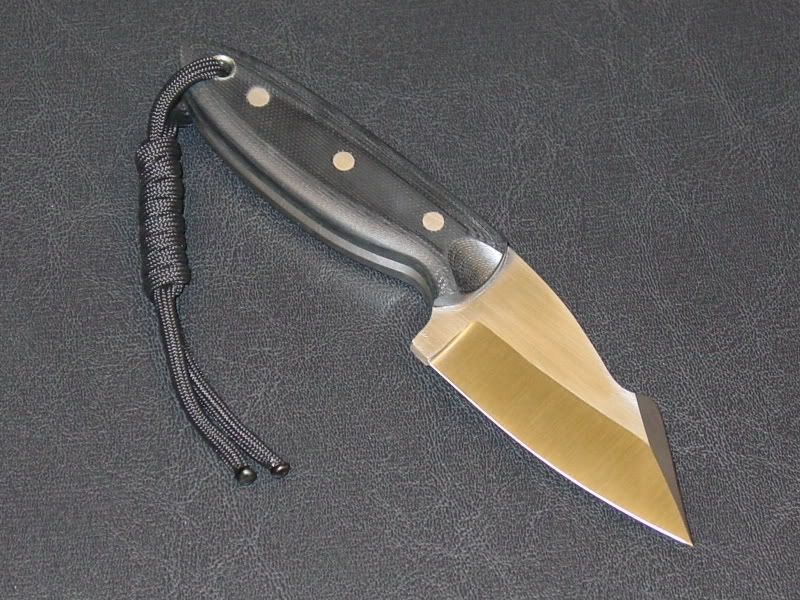

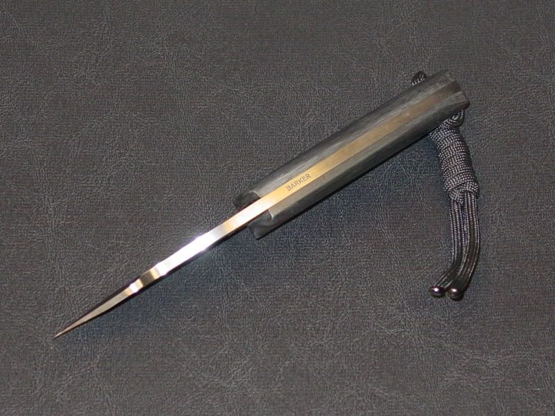

I made this knife for a bladeforums member. It is a collaboration of his design and my construction. To be honest, at first I wasn't that thrilled with the design. Mainly because I had only made about 25 knives at the time he contacted me and didn't know if I had the skills to pull it off. But, because I'm a custom maker I 'm up for anything. Well as I got a few more knives under my belt and more knowledge I finally finished this one. I call it the Cur Dog because it is a mix of sorts, it's small and strong and cuts like nothing I've ever made before. The blade is 3" long made of 5/32" CPM154. The grind is hollow on the left side and flat on the right with a swedge. I ground them down to a less than .005" egde and put the secondary bevel on the hollow ground side. It also has a fore finger groove. The handle is 3.5" long black G10 scales with corby bolts. Thumb grooves on each side. I have to admit this design is awesome and my hat is off to Jon Law who designed it. It was my plesure to make it for him.
Your comments would be greatly appreciated.
