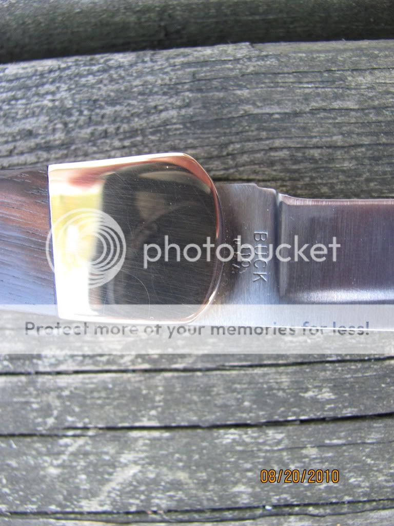

without pics and based on the stamp not being inverted, sounds like a 5th ver 3rd variation
Actually, just read your whole post and saw the wood and 3 inlay rivots. There were some 110s either 07 or 08 that came through without date stamps. Could be your man.
imafritz, my knife's blade is stamped exactly as the one in your picture. The pin configuration is different, with mine having three pins that appear to be larger in size. It is in very good condition, so you are probably right in that it is an 07 or 08 without date stamps. I will post some pics as soon as I can.

My pleasure. All 5th 3rds have 2 inlay and when I actually read, seeing large headed , I knew it wasn't that. But I had already pasted the pics so what the heck.
