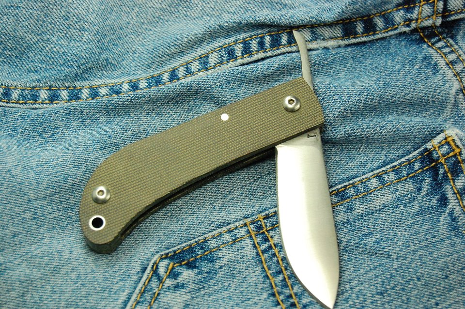

I have an excellent JK Friction folder.
The extending tang does make itself known, and that is why when I carry that knife, I carry it in my back pocket.
As you surmised, the tension on the pivot is all that controls how easily the knife deploys, so you do have to be aware that the possibility exists that the blade could creep out under certain circumstances.
On the other hand, the extended tang makes for a very solid positioning of the blade when open, and when gripping the knife, at least on my example, my hand keeps the tang in place and tends to prevent the knife from closing.
I do not prefer a friction folder over a locking blade or a plain old slip joint, but I do appreciate them for what they are.

That JK fricky is gorgeous, mqqn! Coro- So is that^ one!

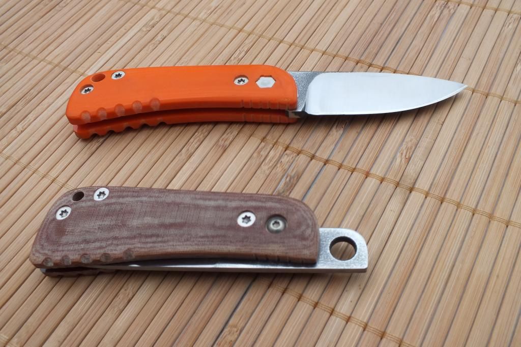

The friction folders I make, are based on the Japanese higonokami.
My friend Filip De Leeuw has been making friction folders long before I did. My first EDC friction folder I designed and filip made it.
That knife opened a couple of times just enough in my pocket to hurt me.
The folders I make do not have that problem: the "tail" is long enoug h to ope the blade one handed, keep it open during work, but not long enough to to open the knife in the pocket.
The screws make the tension on the blade adjustable so the blade opens smooth, but with some force.
I have kiridashi, inverted tantopoint and drop point models.
Friction folders are legal to carry in a lot of places where locking folders are not permitted.
Orange G10 and natural Micarta handles, A2 blades
