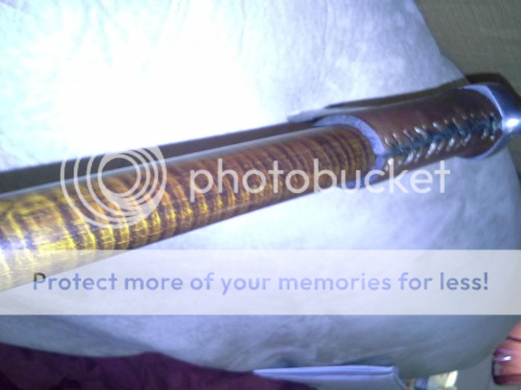

craig barr Damascus hammer pole, curly hickory handle... just finished the leather work today now starting on a sheath.
I used potassium permanganate to highlight the grain on this handle
looks good! I was very fortunate to find a great piece of wood from dunlap woodcraft. I used chromium trioxide on it sever times and always wiped down with vinegar/water mix after each stain.
what did you use around the top of the hawk head. just starting to play around with hawks and it looks nice.
Thanks, I wrapped it with natural colored artificial sinew and then rubbed a liitle brown leather dye over it to give it an aged look.
