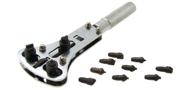

My new pt has developed slight side to side blade play... Not a huge deal but would like to be able to adjust it. I have researched the subject a bit and didn't find many ideas... Anyone taken apart one of these? Also pics and or links would be greatly appreciated. Thanks!

A watch case wrench might work too, depending on the fingers in the set.
Thanks a lot for the advice and pics, guys. I will look around my local blowes for the circlip pliers and I do have a set of small flat head screw drivers that should do the trick, I hope. Thanks again!
